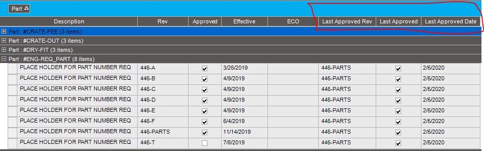

Has anyone had any experience with PartRev I would like to say the latest PartRev in a BAQ at the moment I am pulling all of them back e.g if we have A B C it’s displaying them all when the latest one is C but the end user doesn’t want to enter a date.

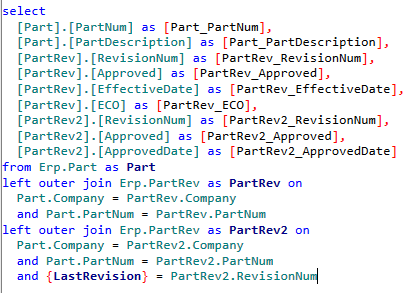

I’ve got this far
Summary
select
[Part].[PartNum] as [Part_PartNum],
[Part].[PartDescription] as [Part_PartDescription],
[LastRevision].[PartRev_RevisionNum] as [PartRev_RevisionNum],
[LastRevision].[PartRev_PartNum] as [PartRev_PartNum],
[LastRevision].[PartRev_Company] as [PartRev_Company],
[LastRevision].[Calculated_RANK] as [Calculated_RANK]
from Erp.Part as Part
left outer join (select
[PartRev].[Company] as [PartRev_Company],
[PartRev].[PartNum] as [PartRev_PartNum],
[PartRev].[RevisionNum] as [PartRev_RevisionNum],
[PartRev].[EffectiveDate] as [PartRev_EffectiveDate],
((ROW_NUMBER() OVER (PARTITION BY PartRev.Company, PartRev.PartNum ORDER BY PartRev.EffectiveDate DESC))) as [Calculated_RANK]
from Erp.PartRev as PartRev
where (PartRev.AltMethod = ‘0’ and PartRev.EffectiveDate <= @Today)) as LastRevision on
Part.Company = LastRevision.PartRev_Company
and Part.PartNum = LastRevision.PartRev_PartNum
What is confusing? … looks ok to me as long as Altmethod = ‘0’ is valid for you.
To test, force part.partnum = a part that you know has multiple revisions. You shall see all the revisions in your result (as I showed in my example, 3 revisions having different effective dates ).
Then you can add, on the added subquery LastRevision, the constraint Calculated_Rank=1 to get only the top revision record…
