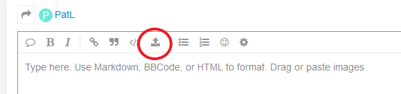

This forum needs a code tag.
Thanks Olga - yes it seems to be broken on the newest version of excel with the company selector.
if i remove the company selector it works fine.
I can work around it by using a macro but it would be great to fix this!
Cheers
Patrick
It has one
See FAQ Code Syntax Highlighting in Posts - FAQ - Epicor User Help Forum

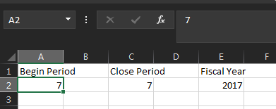

Well if this works for someone, this is what I have for OData with Excel. I don’t use Postman
