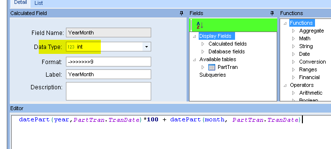

Are you trying to make a BAQ column that contains just the year and month of a date?
Try
Make sure you use type Int
That’ll give you:
One last thing… I’d avoid using reserved words for variable or field names.

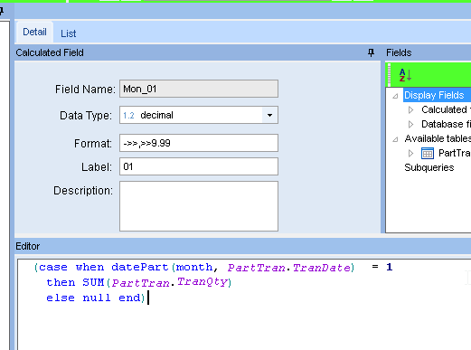

If its the first make 12 calc fields with the formula
Replacing the 1 with the month number for that column
The other columns will need to be in a group by
You’ll get:
