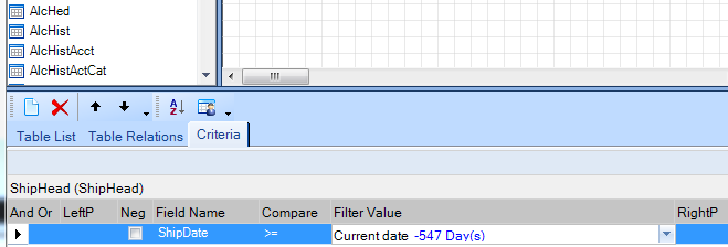

Any DB cleanup/maintenance/reindexing is worth a look; however, a BAQ report is a post-filter and the controls do not limit the scope of the BAQ. If you can find out what’s the absolute earliest date someone would want a report to be run for, you can put an absolute limitation on the BAQ itself, and then you’re cutting your processing time. It’s a good idea to put a note on the dashboard or report, reminding the user that regardless of date range settings, the reporting tool can only go back so far. Also, you may benefit from using a relative date such as in this case where we report something for the past 18 months:
