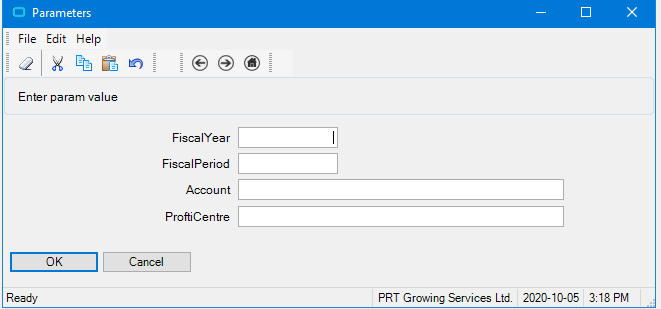

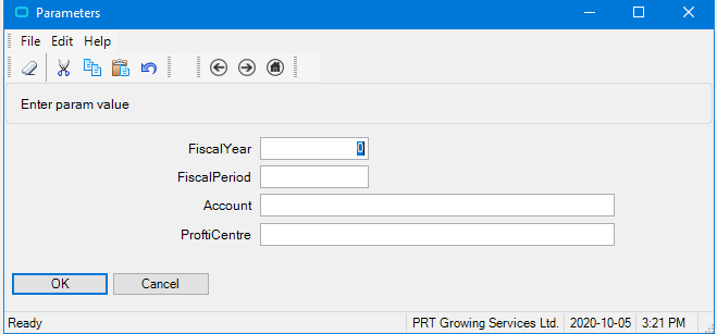

I’ve created a defined parameter for fiscal year, and I’ve set to skip if empty. However, when I don’t enter anything in the field, the BAQ is automatically entering a 0, which of course brings back no results:
Does anyone know why that’s happening?
