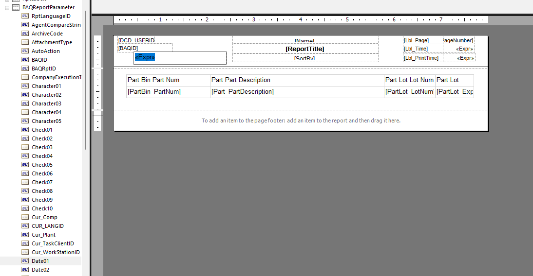

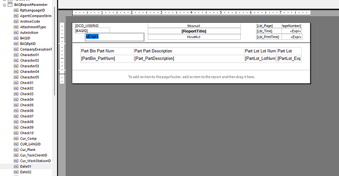

Here is my RDL from my BAQ
the Date01 parameter field is passed over but how do i use it to filter the report

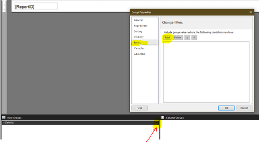

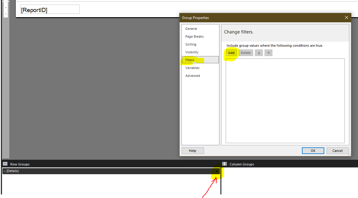

Try adding filters to you Row Groups.
At the bottom of the screen, click the little down carrot.
Click “Group Properties”
Click Filters… Add… Choose your Date01 field and then set up the operator and value bits.
Save, upload, test, repeat.
