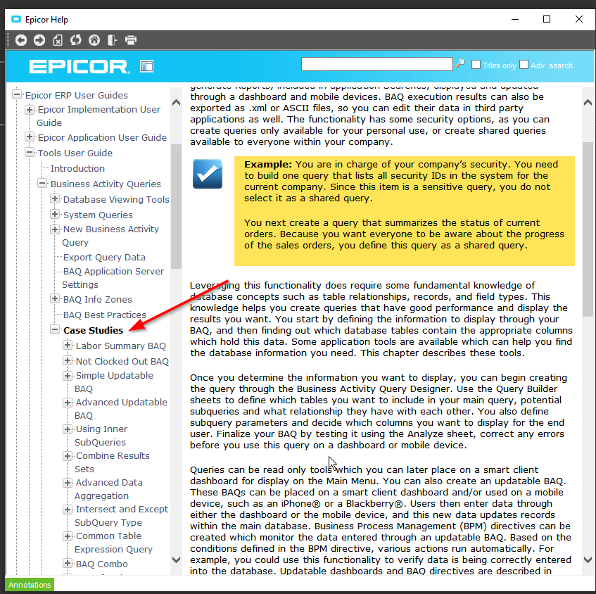

Also, Can I assume that you have read through the BAQ section in the tools user guide? If you haven’t you should drop what you are doing and read through that first. It will give you some of the basics that you need. Pay special attention when you get to aggregate functions, that’s what you are going to need for this BAQ. Once you are done reading through that, and creating a couple BAQ’s following along the case studies, come back with questions.

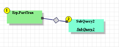

I would make a sub-query that of the PartTran table with the following:
  • Table Criteria: TranType = MFG-STK or MFG-CUS
  • Display fields:
    • Company
    • PartNum
    • MAX(TranDate) MAX(TranNum)
Then relate that to the PartTran on the main query (relating all three fields). You should get the last PartTran record for each PartNum for trans of MFG-STK or MFG-CUS. The MtlUnitCost should give you the answer
with the relationships:
the inner-subquery:
I know the calc field name is Date, but its actually the TranNum
