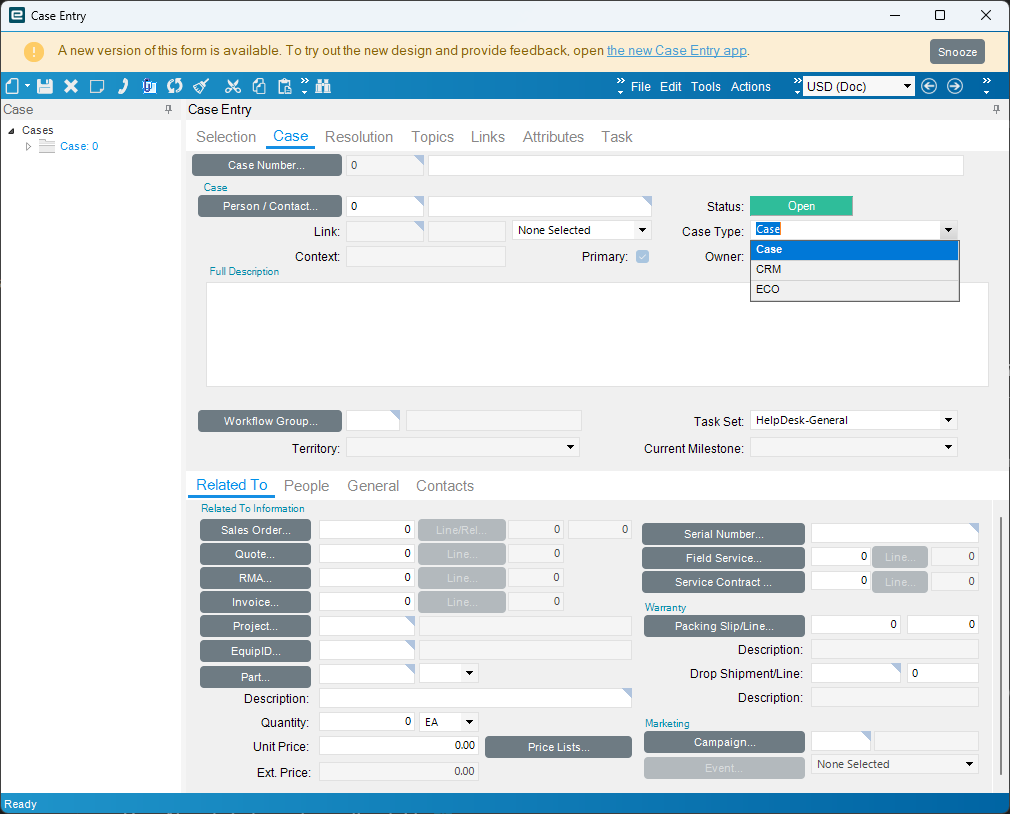

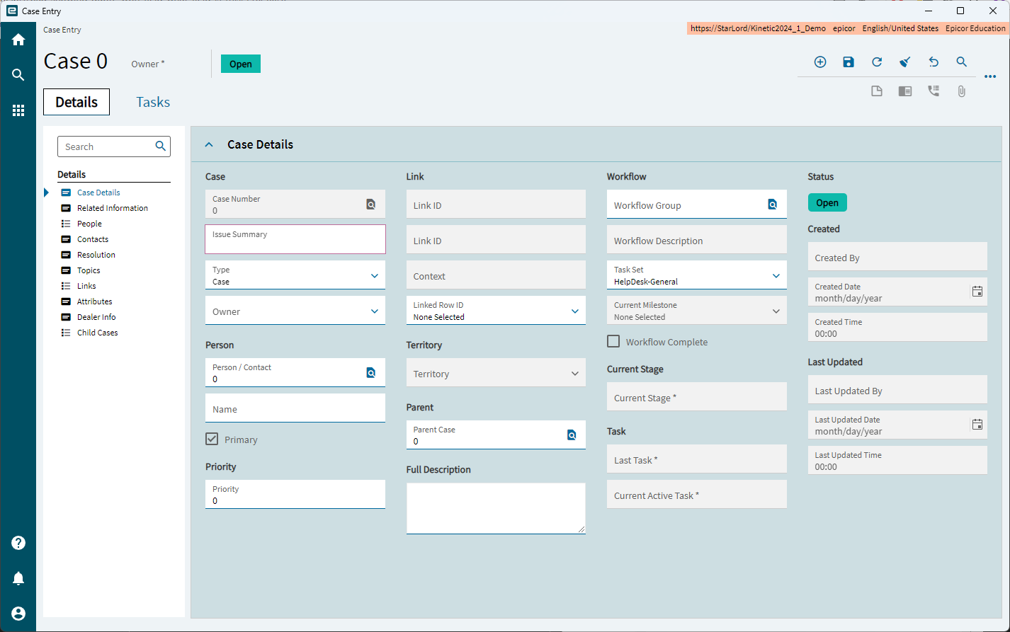

Not wanting to overcomplicate things, but if you have help desk /CRM you could have a case tied to the quote and you could use Cases to manage your quotes. Case management also has a type for ECO if you ever need to swap to that changing the MOM method (pardon the pun)
I want to hear more about this. We do have CRM, but not heard of help desk. I love the idea of the Case to drive the quote updates, but would need to process map it a bit.
@ToryD I always call it by its service name. I mean Case Management. The think I like about cases is that you can link to to many things, not just quotes, other cases, projects, parts, RMAs etc as well as having the different Case types (as mentioned earlier)
I think it’s a pretty underutilized part of the system, and interested to have other peoples opinion on it.
EDIT
The correct menu is Case Entry
