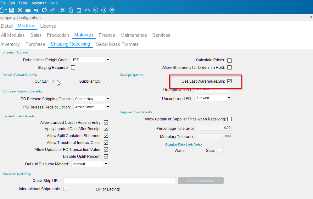

When you receive, there is a button to “set receiving locations” (or something like that)… when you press this button, I think that it looks up the default bin for the part. But if you dont press this button, I believe that it will put it into the INSP bin.
Also take a look at company config for this setting:
Company Configuration-Shipping Receiving Fields
If the Use Last Warehouse/Bin check box is selected (true), and an Advanced Material Management (AMM) license is installed:
  • By default the application shows the Receiving Whse/Bin from Site.
  • If the To Location button is enabled, it will use the same warehouse/bin from the last receipt line that makes the part.
  • If no Primary Bin is defined, the Bin field is blank.
