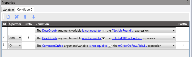

  6. Make a condition with:
  7. Then connect an email Widget to the True output.

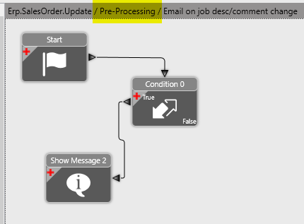

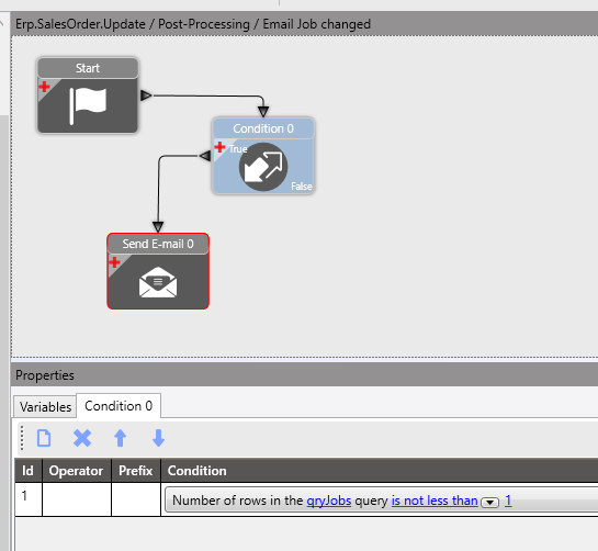

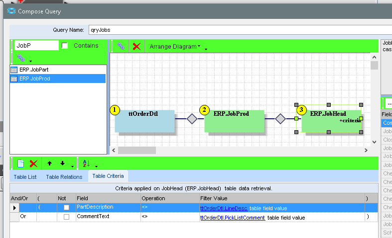

Or how about this Method Directive on SalesOrder.Update

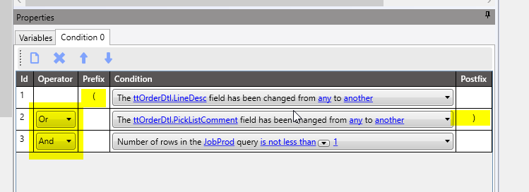

with Condition’s qryJobs of:

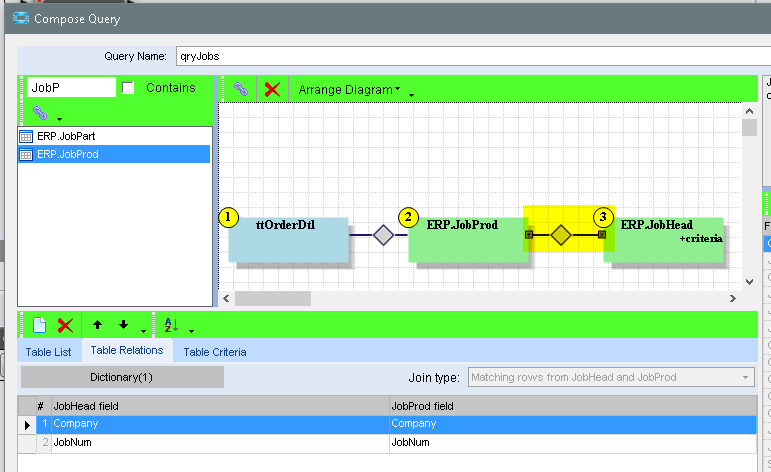

And the table Criteria:
And by adding the JobProd table in there, it doesn’t requires that the JobNum be in the
OrderNum-Line-Rel format.

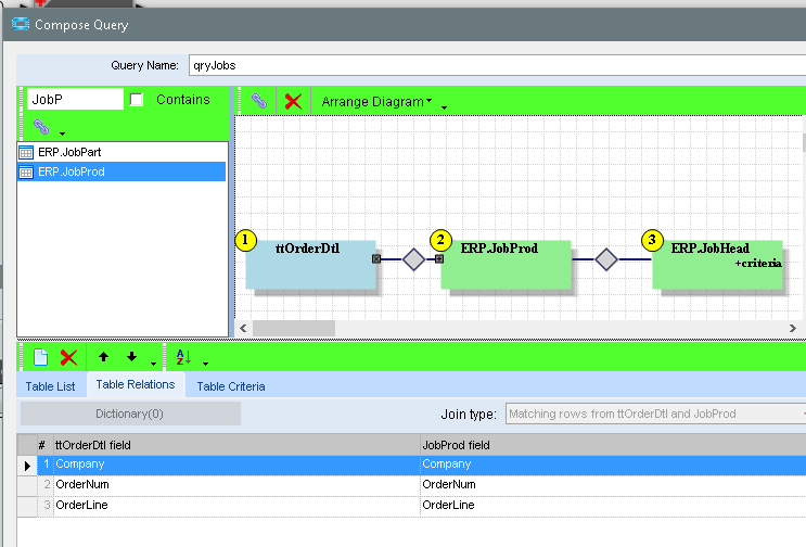

That seems to simple… I must be missing something.

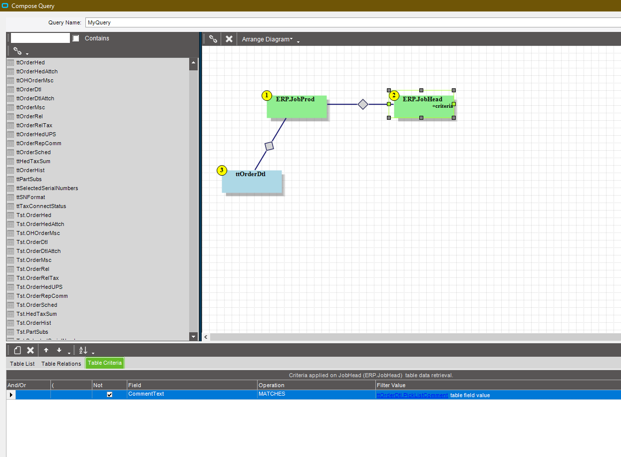

I was trying something very similar to that, it gets results in the BAQ designer but not the BPM one… very strange
I’ve got exactly what you have shown, but it seems to think the comments don’t match even when they do… Any ideas?
I tried Not Matches as well, same problem:

I think this will work (with some limits)
Condition0:

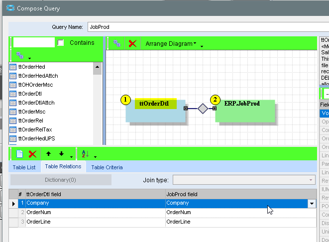

With the JobProd query:
Note that’s the ttOrderDtl table and not the ttOrderRel table. And that there’s no relationship to the Release number.
It won’t be able to tell you the JobNum’s that don’t match, but you could use order tracker with the OrderNum and OrderLine to find the related job(s).

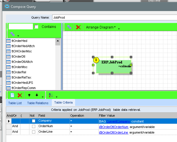

And before I get scolded for linking a ttTable to a Db table …
Make variables to hold the OrderNum and OrderLine, then make the JobProd query:

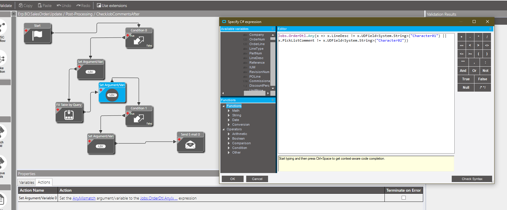

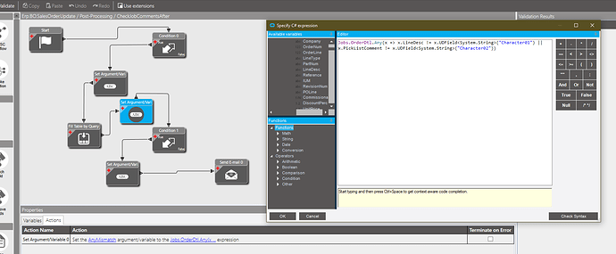

I ended up doing this a slightly different way because I wanted the exact lines with differences.
  • Pre-processing BPM - if description or job comments changed enable post processing BPM.
  • In post processing BPM, fill table with query containing both job and order descriptions and comments. Put the job description in Character01 and the job comments in Character02.
  • Make a boolean variable and assign it the following:

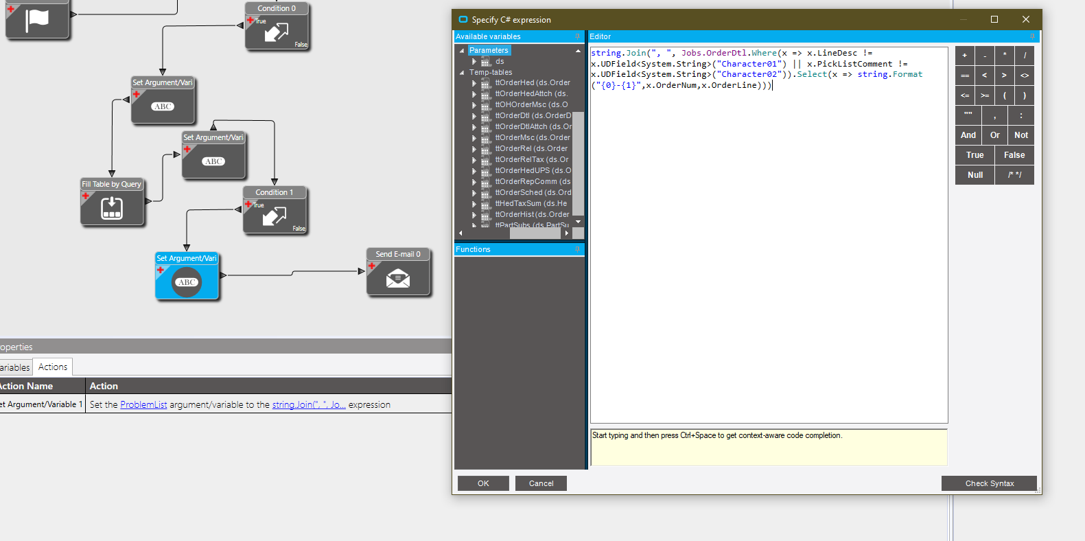

  • If the boolean is true, make a list of lines with mismatching information with the following string variable:
Then the list of order lines with problems can be used in an email etc.
