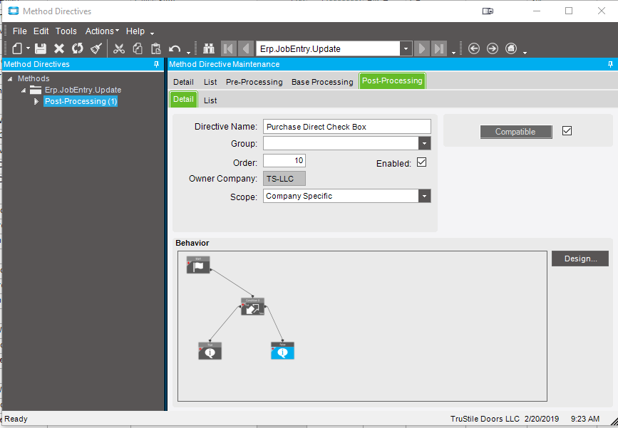

Having an issue with, what seems like a simple condition, statement. Here is my Method Directive.
All I’m trying to do is see if the material description contains the word “Glass” But it keeps returning false image

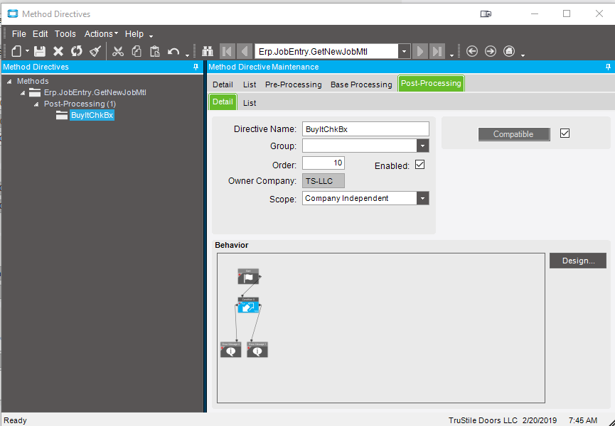

Also you are doing this on GetNewJobMtl… I dont think the JobMtl comes in with a Description out of the gate… you might have to do it on the Update?

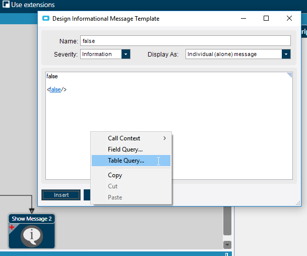

In the message box, do a table or field query, (right click in the message box, there are options there) and it will give some options so that you can see what is coming back. It really helps with troubleshooting.

I concur with these two gents. The GetNew doesnt actually do anything other than slap a new row in your dataset. The real magic happens OnUpdate where RowMod = “A” (added)

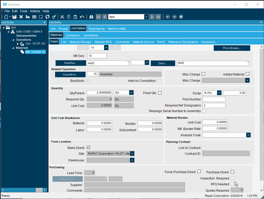

Below is the actual job record.
I am adding the last line by doing a “Past Insert” if that makes a difference.

Try adding more debug info into the messagebox… display the actual contents of the Description field, as well as the RowMod field to make sure that you are getting what you truly expect to get.

All the parts are created by an outside configurator and then added to the job.So actually none of the parts are even in the parts master. So when users have to manually add material it always defaults to purchase direct when, in fact, the only thing that gets purchased direct is glass. So the intention is to uncheck the purchase direct check box for everything except glass.
