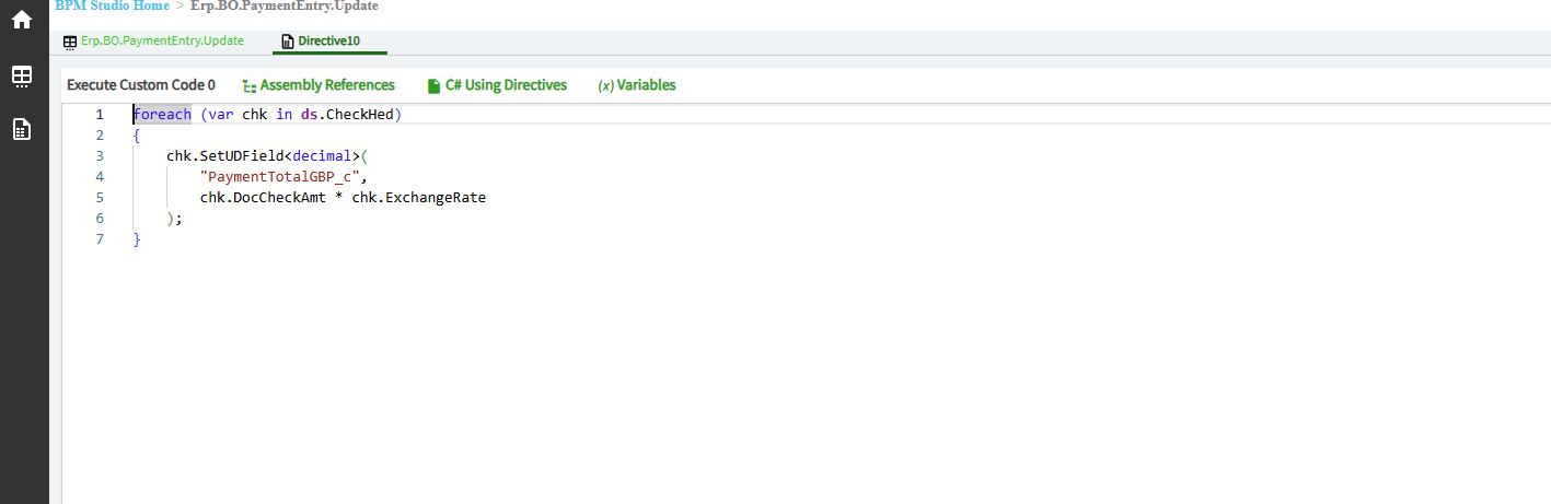

I am trying both Method and Data directives on PaymentEntry or CheckHed to populate a custom field on checkhed with a calculate based around DocCheckAmt * ExchangeRate. I have tried both widgets and C# and i cannot get it to populate.
This is my latest effort (Or lack of :rofl:)
C# i last did when i was in college so please dont laugh

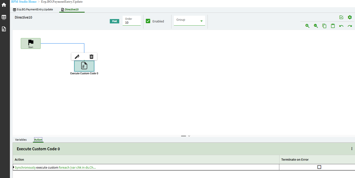

Pre or post processing method directive?
Post
That’s your problem. Change it to pre, or you have to call update again.
In post, the update has already happened, further changes to the fields will not update unless you handle it’s processing.
Do you think the code should work if i move it to Pre?
It should, as long as the DocCheckAmt and ExchangeRate is populated with the correct value before update.

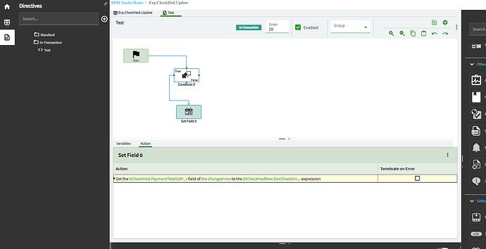

You could also use an in-transaction data directive.

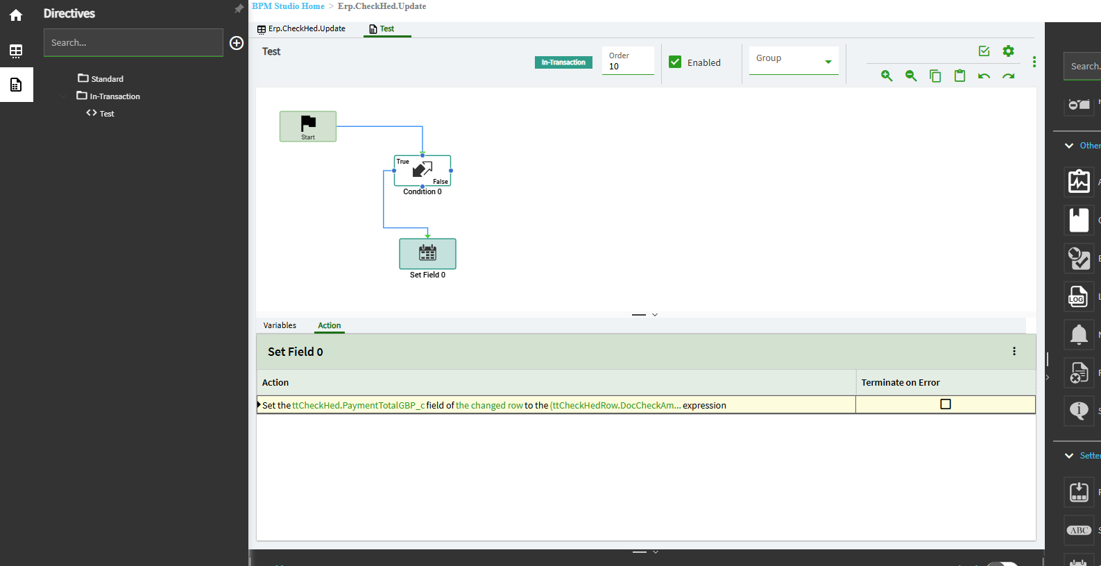

Got it working in an In-transaction data directive using
OK so i thought the above worked and it does to pull in the details to the field but when Finance go to process the payments, they are getting the following error -
Program Ice.Services.Lib.RunTask when executing task 22636 raised an unexpected exception with the following message: RunTask: Ice.Common.EpicorServerException: BPM runtime caught an unexpected exception of ‘MissingMethodException’ type. See more info in the Inner Exception section of Exception Details. —> System.MissingMethodException: Method not found: ‘Void Erp.Tables.CheckHed.set_PaymentTotalGBP_c(System.Decimal)’. at Epicor.Customization.Bpm.DB.InTranDirective_CalculateGBPTotal_51FF858792234A7B97983CB013C79EFD.A001_SetFieldAction() at Epicor.Customization.Bpm.DB.InTranDirective_CalculateGBPTotal_51FF858792234A7B97983CB013C79EFD.ExecuteCore(Int32 step) at Epicor.Customization.Bpm.DirectiveBase`2.Execute() in C:\_releases\ICE\ICE5.1.100.6\Source\Server\Customization\Epicor.Customization.Bpm\DirectiveBase.Generic.cs:line 341 at Epicor.Customization.Bpm.DirectiveBase`2.Execute(TParam parameters) in C:\_releases\ICE\ICE5.1.100.6\Source\Server\Customization\Epicor.Customization.Bpm\DirectiveBase.Generic.cs:line 195 — End of inner exception stack trace — at Epicor.Customization.Bpm.DirectiveBase`2.Execute(TParam parameters) in C:\_releases\ICE\ICE5.1.100.6\Source\Server\Customization\Epicor.Customization.Bpm\DirectiveBase.Generic.cs:line 211 at Epicor.Customization.Bpm.TriggerBase`2.RunDirectives(TriggerParameters`1 parameters) in C:\_releases\ICE\ICE5.1.100.6\Source\Server\Customization\Epicor.Customization.Bpm\TriggerBase.cs:line 51 at Epicor.Customization.Bpm.CustomizationBase2`2.Execute(TParam parameters) in C:\_releases\ICE\ICE5.1.100.6\Source\Server\Customization\Epicor.Customization.Bpm\CustomizationBase2.cs:line 99 at Epicor.Customization.Bpm.InTranTriggerBase2`2.Write(LinqRow newRecord, LinqRow oldRecord) in C:\_releases\ICE\ICE5.1.100.6\Source\Server\Customization\Epicor.Customization.Bpm\InTranTriggerBase2.cs:line 103 at Ice.Triggers.TriggerQueue.ExecuteBpmWriteTrigger(IceDataContext context, LinqRow modifiedRecord, LinqRow originalRec) in C:\_releases\ICE\ICE5.1.100.6\Source\Server\Framework\Epicor.System\Triggers\TriggerQueue.cs:line 349 at Ice.Triggers.TriggerQueue.RunWriteTriggerInNewLevel(IceDataContext context, LinqRow modifiedRecord, LinqRow originalRecord, Boolean forAddedRow) in C:\_releases\ICE\ICE5.1.100.6\Source\Server\Framework\Epicor.System\Triggers\TriggerQueue.cs:line 172 at Ice.Triggers.TriggerQueue.RunAtNewLevel(Func`1 buildTriggerRunState, Action action) in C:\_releases\ICE\ICE5.1.100.6\Source\Server\Framework\Epicor.System\Triggers\TriggerQueue.cs:line 498 at Ice.Triggers.TriggerQueue.RunTriggers(IceDataContext context) in C:\_releases\ICE\ICE5.1.100.6\Source\Server\Framework\Epicor.System\Triggers\TriggerQueue.cs:line 56 at Ice.IceDataContext.RunUntilAllTriggersHaveExecuted() in C:\_releases\ICE\ICE5.1.100.6\Source\Server\Framework\Epicor.System\Data\EntityFramework\EF6\IceDataContext.cs:line 835 at Ice.IceDataContext.SaveChanges() in C:\_releases\ICE\ICE5.1.100.6\Source\Server\Framework\Epicor.System\Data\EntityFramework\EF6\IceDataContext.cs:line 889 at Erp.Internal.AP.ProcessPayment.processChecks(FormatNumberToCheckAmountCache checkAmountFormatterCache) in C:\_releases\ERP\ERP12.1.100.6\Source\Server\Internal\AP\ProcessPayment\ProcessPayment.cs:line 2508 at Erp.Internal.AP.ProcessPayment.RunProcess(Int64 instanceTaskNum, String outputFileName) in C:\_releases\ERP\ERP12.1.100.6\Source\Server\Internal\AP\ProcessPayment\ProcessPayment.cs:line 724 at Ice.Hosting.TaskCaller.InnerExecuteTask(IceDataContext newContext) in C:\_releases\ICE\ICE5.1.100.6\Source\Server\Framework\Epicor.Ice\Hosting\TaskCaller\TaskCaller.cs:line 71 at Ice.Hosting.TaskCaller.ExecuteTask() in C:\_releases\ICE\ICE5.1.100.6\Source\Server\Framework\Epicor.Ice\Hosting\TaskCaller\TaskCaller.cs:line 62 at Ice.Lib.RunTask.BpmFriendlyTaskLauncher.Run(String sessionIdPrefix, IceContext db, Action taskRunner) in C:\_releases\ICE\ICE5.1.100.0\Source\Server\Services\Lib\RunTask\BpmFriendlyTaskLauncher.cs:line 57 at Ice.Services.Lib.RunTaskSvc.InnerRunTask(Int64 ipTaskNum, Boolean suppressTransaction) in C:\_releases\ICE\ICE5.1.100.0\Source\Server\Services\Lib\RunTask\RunTask.cs:line 349
