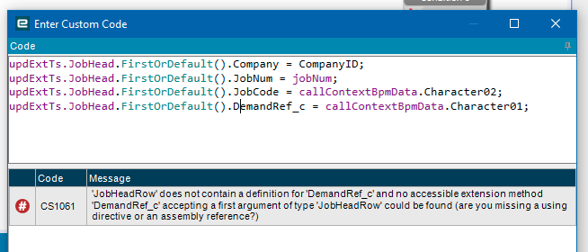

I understand. We want every job that goes to the floor to have an SO. So I took your information and made the BPM on JobReleased. I’m not sure I did it correctly though because I’m getting an error.
  1. I created the BPM Form
  2. I made a Invoke BO Method widget with UpdateExt and set the parameters as you show.
  3. I made a custom code widget and added the lines of code you showed. I put this between the data form and the Invoke BO widgets
    I’m getting this syntax error.
    Did I set this up incorrectly?
The intellisense may not be aware of the UD field. Try
updExtTs.JobHead.FirstOrDefault()["DemandRef_c"] = callContextBpmData.Character01;
Again, you can also use the widgets, which seem to be able to see UD fields even when the code completion tools can’t.
