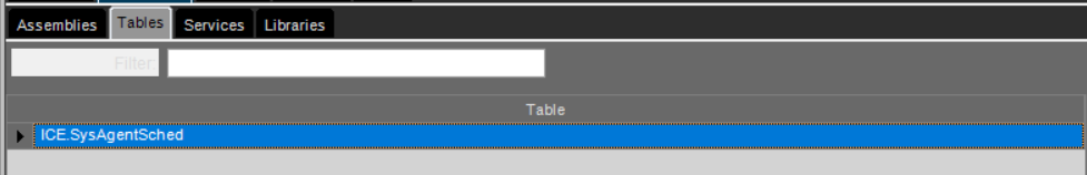

I have a task scheduled that runs every 15 minutes and I want a DD BPM to trigger off of it. I have created an in-transaction DD under SysAgentSched. I have made a condition statement that looks for the description to match the name of the schedule I created and for a change to the next run from any to another. I have written up some C# code that should trigger whenever these conditions are met that will update an existing row of data in the UD02 table. Credit to this post for the idea:
The problem I’m having is that my code doesn’t seem to be writing at all. I have confirmed this code to write perfectly fine in another BPM. I have also tested to be sure that the schedule is working by assigning a task to it. Does anyone have some troubleshooting techniques that I can try?

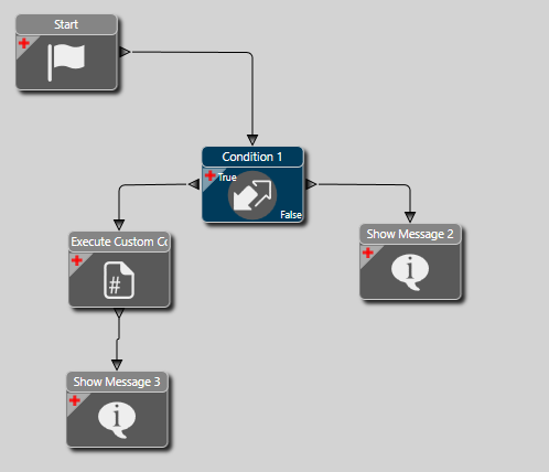

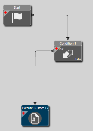

Throw a Show Message widget between the condition and Exec Custom Code widgets, just to make sure that its even coming out of the TRUE port of the condition block.
It doesn’t seem to be trigging on the data side even with the message boxes.
Not sure why, because I can clearly see the tables being updated. Should I try a Standard DD instead of an in transaction?
I went ahead and swapped over to a standard definition and changed the next change to last changed on. After doing this and setting up emails to pop up I get the email from the false side. Thanks @ckrusen for helping diagnose which side we were hitting! In addition I found that we were hitting the false side of the condition because of a typo.

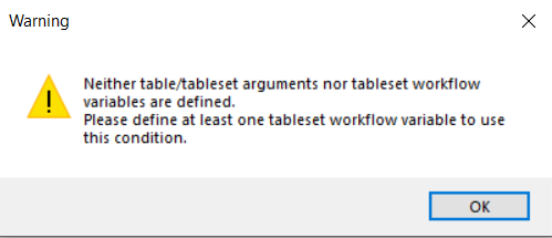

I figured out how to get my c code in there. I would like some help understanding how to call in a table for these functions. I am receiving the following error code when trying to assign a variable:
I have created a reference for the table I would like to use, but maybe this isn’t what I’m supposed to use.

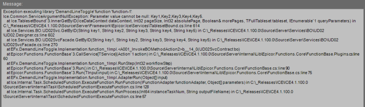

I am now getting the following error whenever the function runs. I get that its related to my keys in UD02 but past that I don’t understand how the parameter value could be blank:

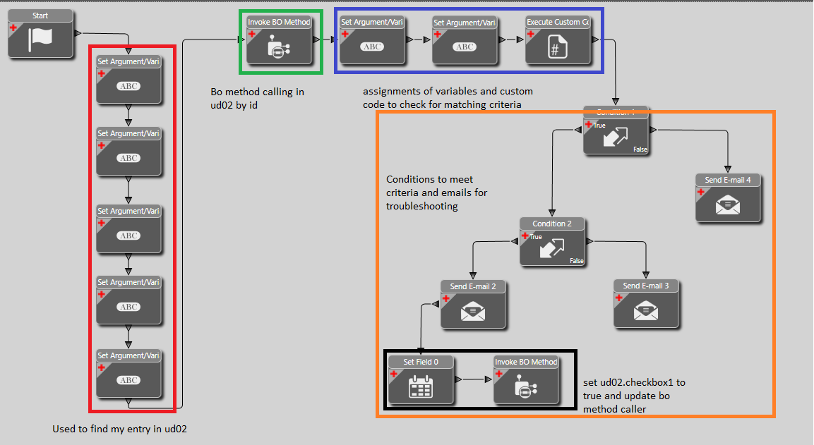

This is what my current function looks like. I just want to pull in the only item in UD02. I believe that using the GetById is how I would go about this. I then have an assign statement to grab the value of Ud02.Checkbox01 and assign it to a variable. Lastly, I want an email to go out if the function operates correctly.

Figured out that the error was that I was passing null values into new parameters key1-5. Solved this by assigning values to the variables before the BO call.

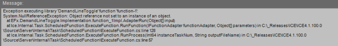

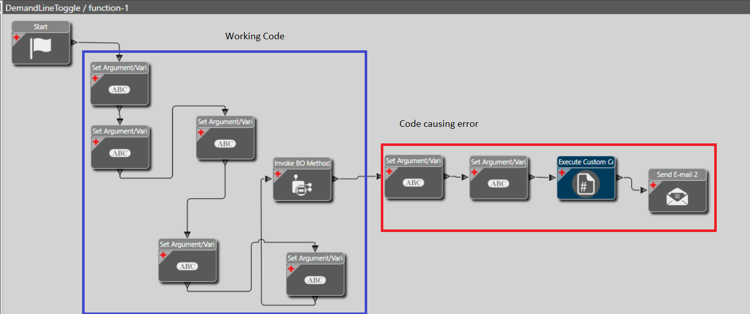

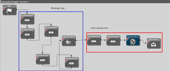

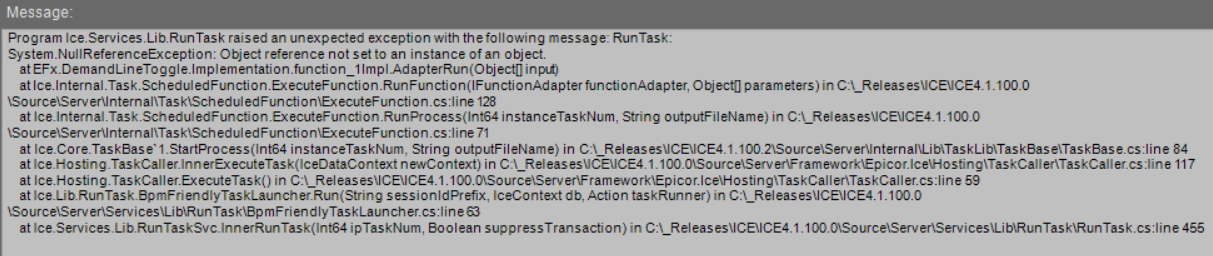

New error below. I have no idea where this one stems from, but I assume it has to do with my variables again, or my c# custom code. New function set up, errors, and C# below:

@josecgomez
I figured out my issue was with my variables. I was placing them under the Request parameters within the signature instead of just setting them up as variables within the function designer.

I am trying to have this function update table ud02 when certain criteria are met. I would like to use the set field widget in function designer. I also thought that after setting the field to true I would need to call in the update bo method caller. Below is what I have created, but it does not push the updates to the ud02 table.
Any tips or tricks on how to update using these widgets?
