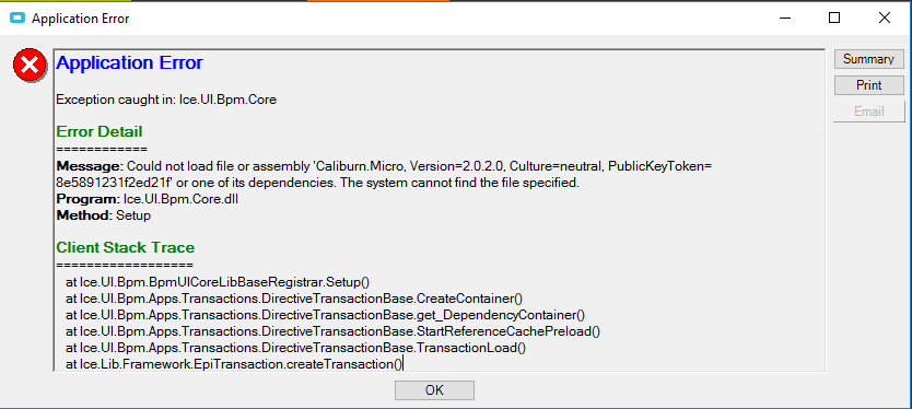

I am currently unable to open Method or Data Directive Maintenance and get the error message attached.
Your client folder is missing that dll.
Reinstall the client.
The problem is I am running this on our server. That does make sense though.
You’re still running it from a client, even on the server.

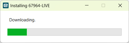

I followed that webpage, everything is working great now. Thank you, Kevin!
And it rears it’s head again.
