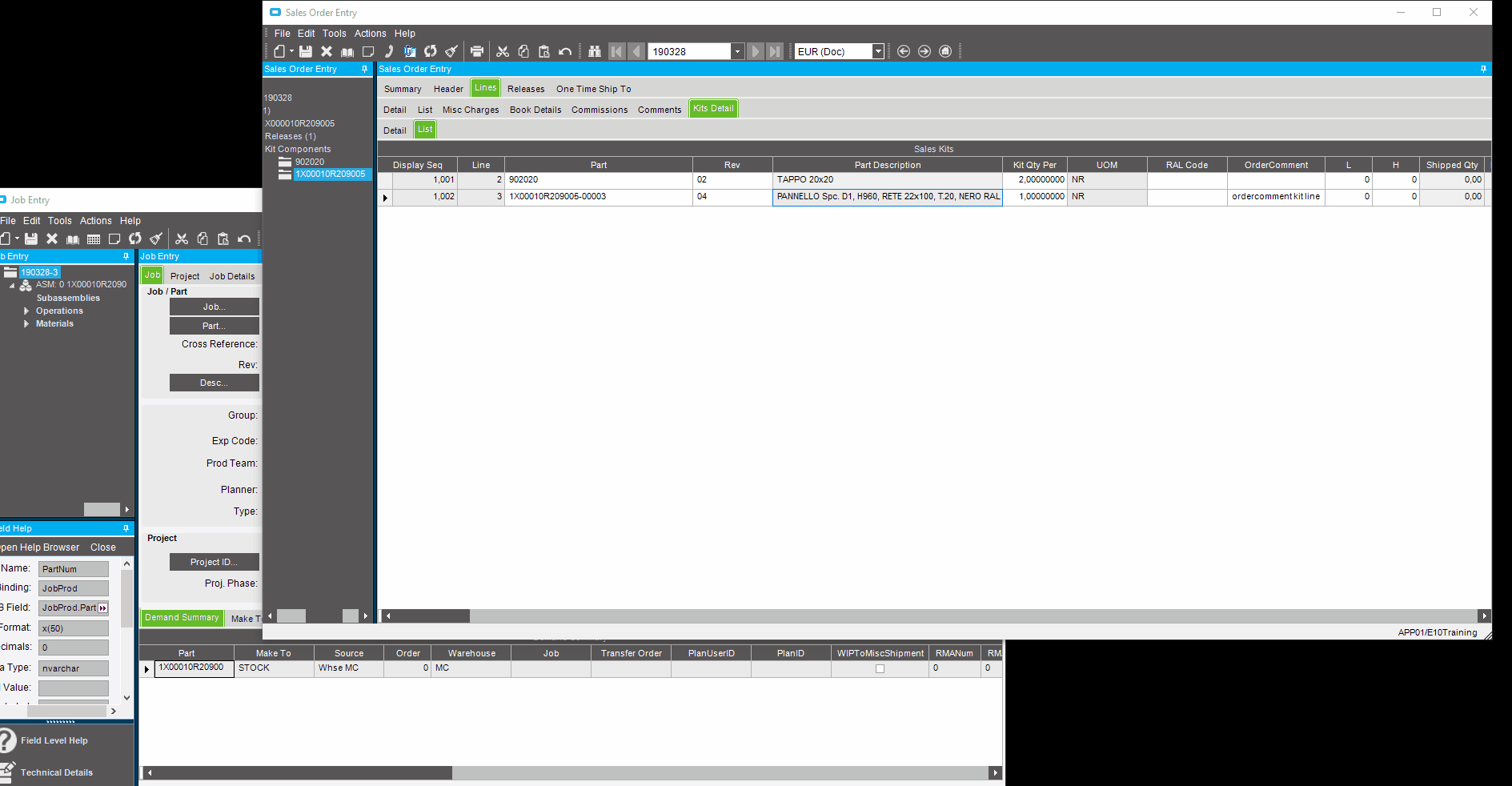

I find myself with Jobs created from some orders (not with the MRP, so they don’t have the same comments as the line/kit of the order).
I need to create something (BPM, customization,…) to copy the order/line/kit comments on the job itself.
I tried with some BPMs (JobEntry,GetRows, GetByID, GetList) but everyone seems not to be working (even with a simple ‘Show Message’).
The only method that seems to be called is GetDatasetForTree.
Can someone explain me why? And maybe address me with some knowledge to make this.

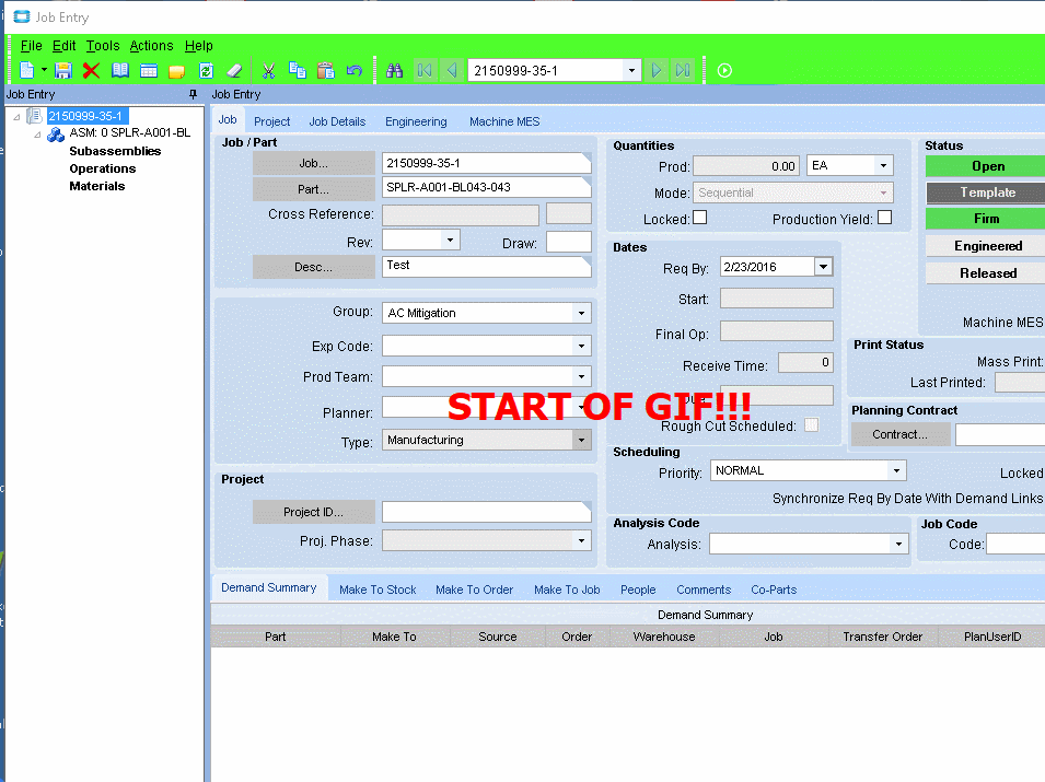

The Pick List/ Job comment automatically copies to the Job comment. Even on manually created jobs (i.e. not using MRP or Job Manager).
It does it after you’ve added an order based demand link.

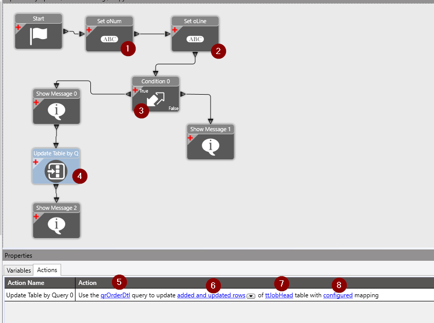

Here’s what I did (which seems to work in the conditions you need)
JobEntry.Update / Pre-Proc
  1. Set variable oNum from the string JobHead.JobNum
  2. Set variable oLine from the string JobHead.JobNum
  3. Check to make sure this JobNum looks like a Order-Line combo
  4. Use Update Table by Query to set JobHead.CommentText
  1. qrOrderDtl
    and
  2. “Added and updated rows”
  3. Table “ttJobHead”
  4. Mapping:
