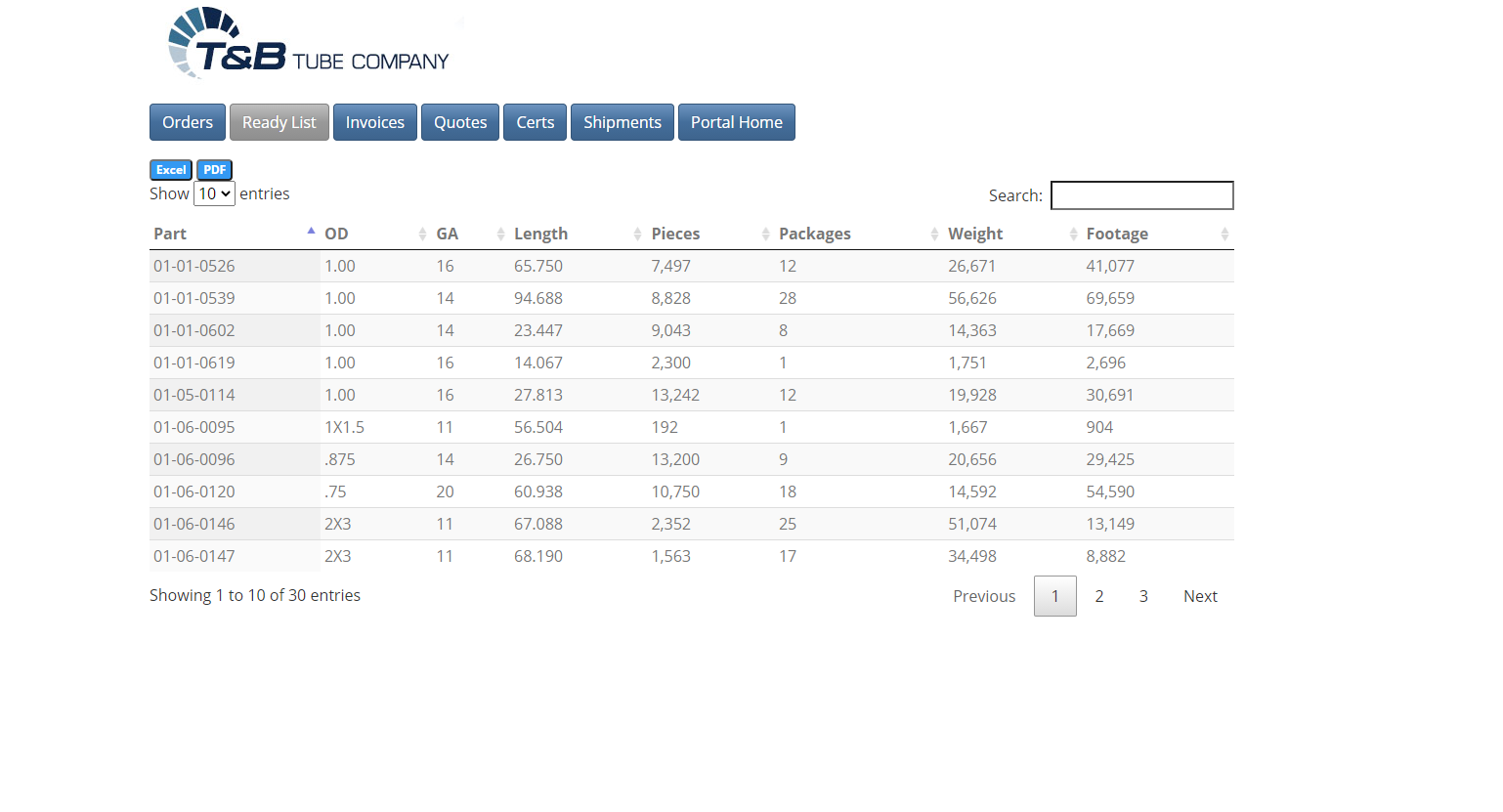

My presentation on this is 7/14 at 10:25am. After working through some authentication challenges, I finished this thing in about 30 days alongside other work. It’s pretty rapid once you get rolling. This is the tech doc that outlines the features of the portal.

Our www.wcibags.com is wordpress and we use woocommerce just to display parts. That app.wcibags.com in the documentation is a custom angular application.
