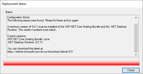

When I trying to install the DEMO Application server I get the following error when I click configure:
I have (I believe) configured all four tabs for the appilcation server correctly.
Any suggestions would be welcome.

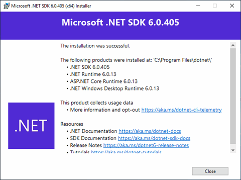

I have found the solution:
The ASP.NET Core Runtime noted in the Mircrosoft.NET SDK 6.0.*** splashscreen when it is installed
is NOT the same as the ASP.NET Core Hsosting Bundle mentioned in the error message.
the following must also be installed: Dotnet-hosting-6.0.**-win.exe
Hopefully this post will save someone else the week of frustration I have just experienced.
