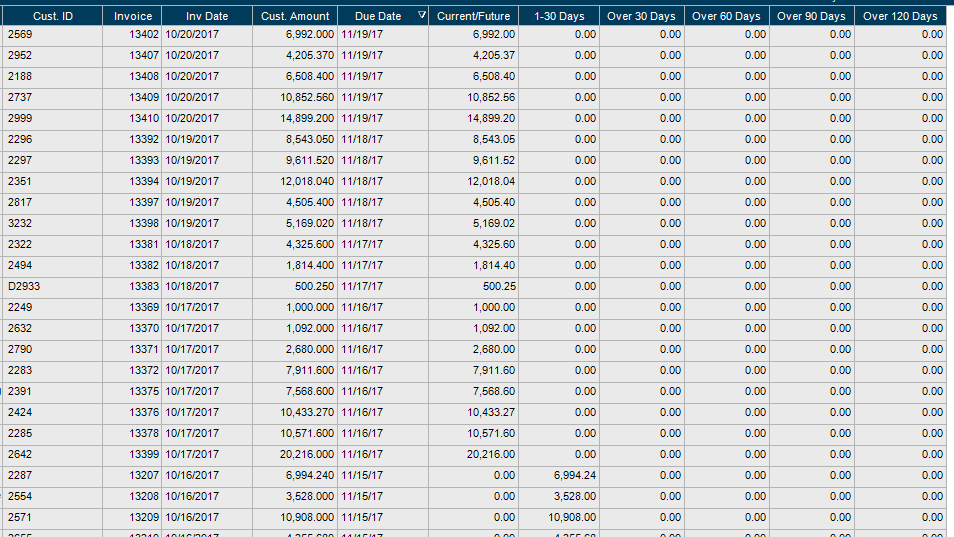

I finished the query for this. Unfortunately I didn’t get to do the original post’s idea of hiding and displaying fields - but I was able to get all the correct information thanks to Brandon’s help.
For future references here are the calculated fields I used:
Current/Future:
(case
when dateadd(day, 0, InvcHead.DueDate) >= Constants.Today then InvcHead.DocInvoiceAmt
else 0.00
end) as [Calculated_CurrentDays],
1-30 Days:
(case
when dateadd(day, 1, InvcHead.DueDate) > Constants.Today then 0.00
when dateadd(day, 30, InvcHead.DueDate) <= Constants.Today then 0.00
else InvcHead.DocInvoiceAmt
end) as [Calculated_ThirtyDays],
Over 30 Days:
(case
when dateadd(day, 60, InvcHead.DueDate) < Constants.Today then 0.00
when dateadd(day, 31, InvcHead.DueDate) > Constants.Today then 0.00
end) as [Calculated_OverThirtyDays],
Over 60 Days:
(case
when dateadd(day, 90, InvcHead.DueDate) < Constants.Today then 0.00
when dateadd(day, 61, InvcHead.DueDate) > Constants.Today then 0.00
end) as [Calculated_SixtyDays],
Over 90 Days:
(case
when dateadd(day, 120, InvcHead.DueDate) < Constants.Today then 0.00
when dateadd(day, 91, InvcHead.DueDate) > Constants.Today then 0.00
end) as [Calculated_NinetyDays],
Over 120 Days:
(case
when dateadd(day, 1365, InvcHead.DueDate) < Constants.Today then 0.00
when dateadd(day, 120, InvcHead.DueDate) > Constants.Today then 0.00
end) as [Calculated_OneTwentyDays]
Here’s a snippet of what the query looks like:

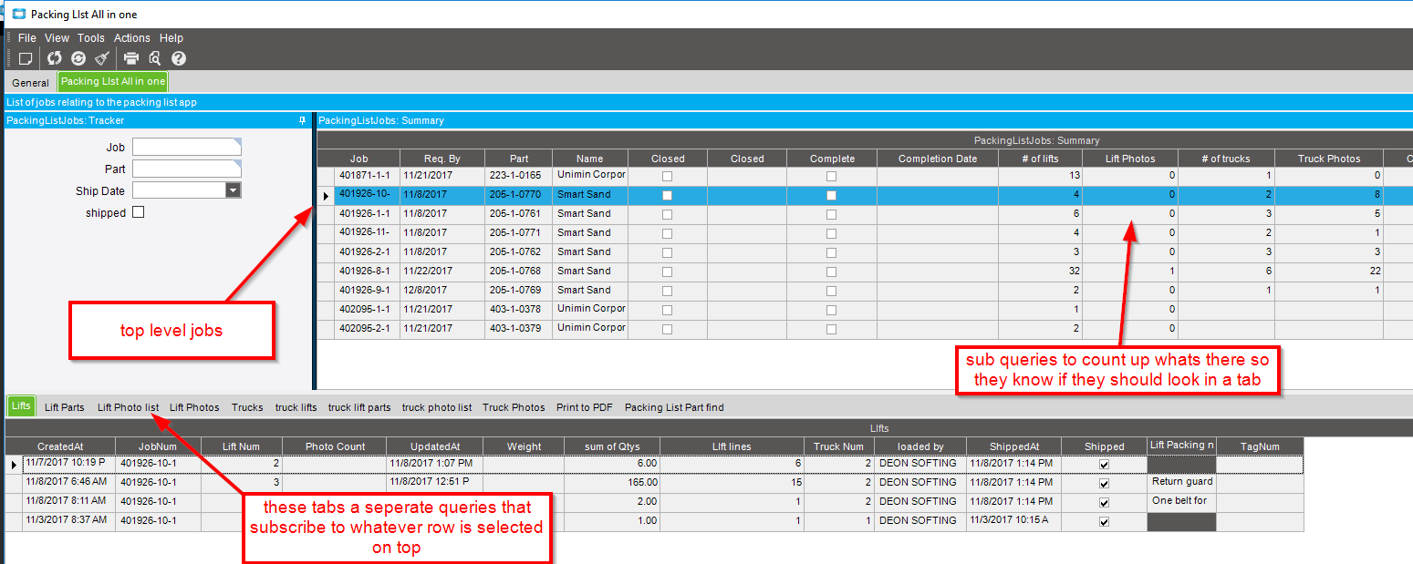

I’m just going to go with something like this (I need to figure out how to get it so that only the correct data will show depending on the tab you’re in) :
In each of these tabs the same data comes in, just the specific calculated field is displayed in it; so users will still see all the invoices in the list. E.g. Invoices that are in “Over 120” will still show up in the “1-30” tab since there’s no parameters being run on the tabs. Of course I can create 4 or 5 different queries and put the specific dates set in place for each one, but it would be nice to find a easier way to do that using one query.

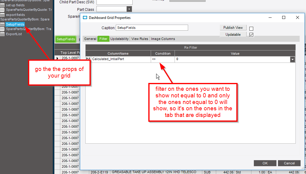

You can put in a filter for each tab. For example, in the 1-30 tab, filter by rows that don’t equal 0.
I do something for a totally unrelated application that I think would work for you. You would create a query that would list all of the customers and add up the number of invoices in each over due category, and then you can have the query you just made subscribe to whatever customer is selected in the top grid to show the individual invoices. Depending on if you want to see things to that filtered of a level.

Oh wow… Duh! I forgot all about the filters under the grid properties. I see no reason why that wouldn’t work…
