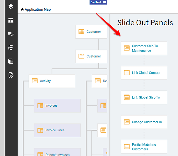

Has anyone customized the Kinetic Call Log Slide Out. Its not available in the Slide Out Panels or anywhere else in the Application map that I can find. Modifying the non-menu item in the process section was the solution for the classic screen, but it doesn’t appear that the same logic applies for Kinetic.
I haven’t and we’ll have to probably call @hmwillett in on this, but I believe this is considered a “global Slide Out” and we may need more capabilities to modify it. SDK maybe? IIRC, global slide outs can be used across applications. I was wondering the same thing about the attachment slide out.

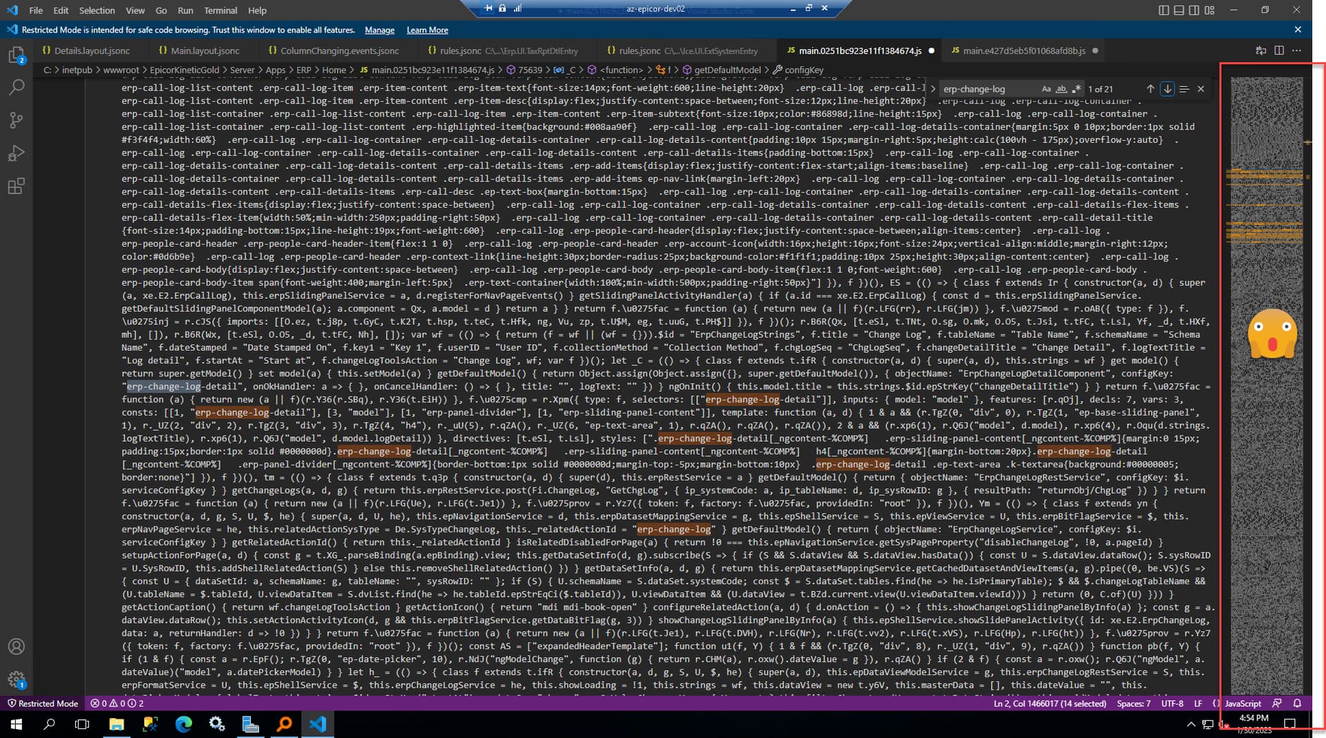

My initial impression is that it’s baked into the application code, called at runtime, and populated with REST. (Yes–I’m looking at change logs and you said call logs. It’s all the same–buried in this awful JS file).
I’m poking my friend to see what she says, but I suspect she’ll come back with a “Sorry, you’re S.O.L.”
