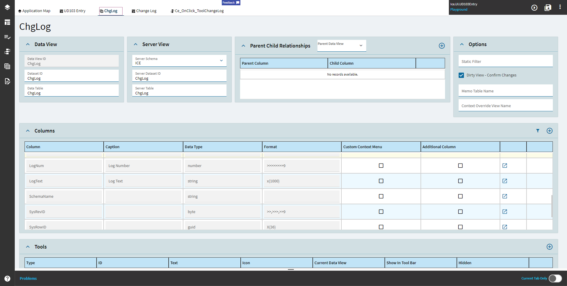

First step is to create a DataView to hold the change log data.

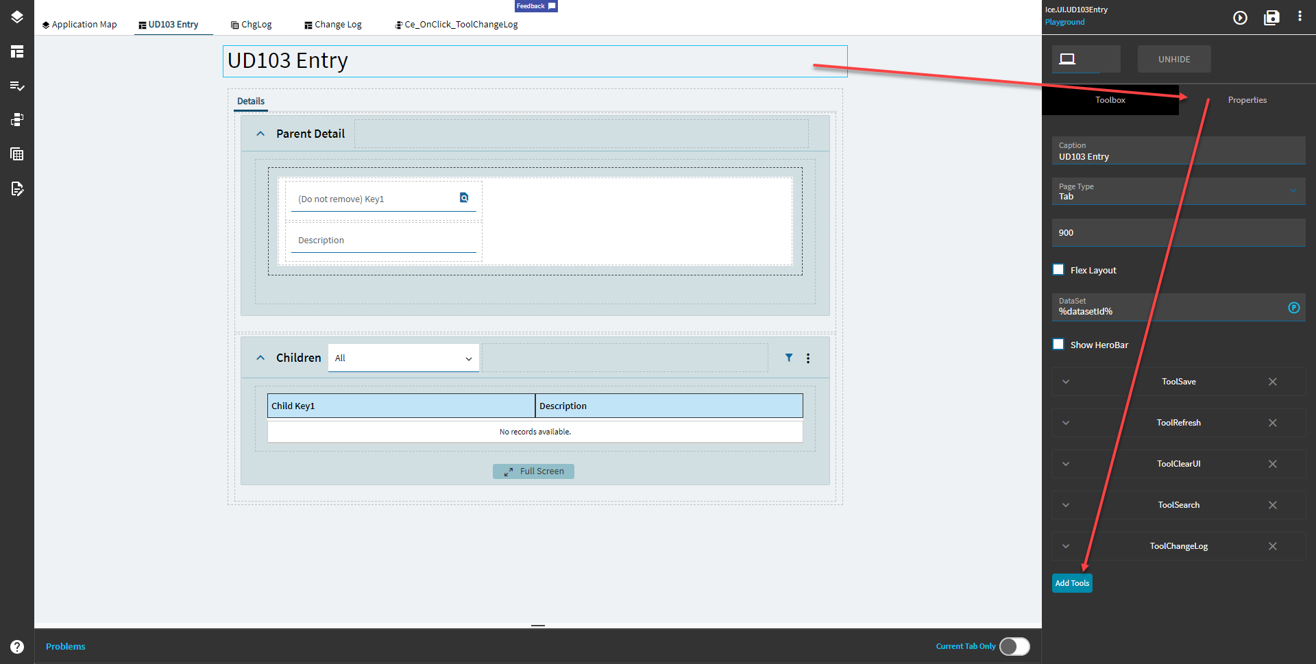

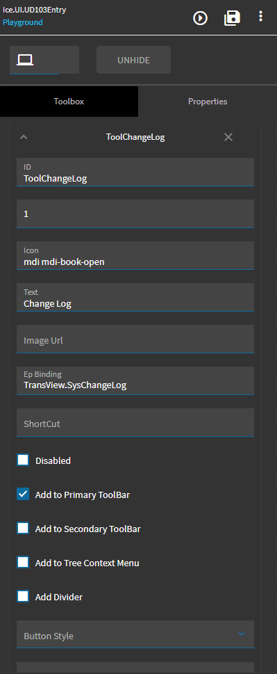

Next, on the screen that holds the title, click the title bar and go to the properties.
At the bottom, there will be a blue “Add Tool” button. Clicky de button and create your tool.

Add a panel card grid and bind the grid model to the DataView you made (I called mine ChgLog).
Show whatever you columns you need (I highly suggest this or you’ll get a ton of columns squished together).

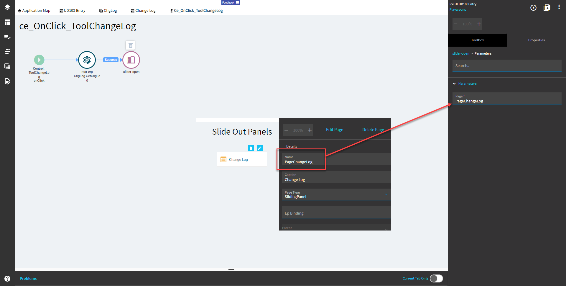

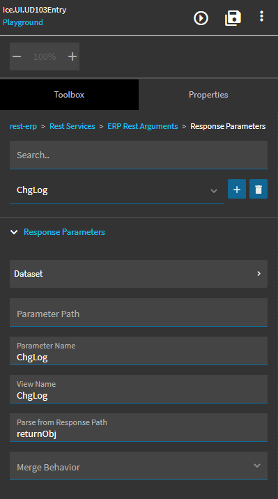

Next, create a new event to populate the grid. This will be “OnClick” for your Change Log Tool.

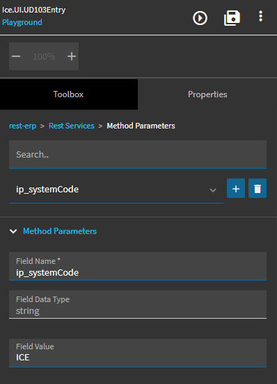

Configure the rest-erp widget.
Finally, add the slider-open widget to open your new change log.

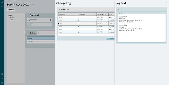

Annnnnnnnnnnnnnnnnnnd voila.
So, natively, Epicor made the DateStampedOn a link which, when clicked, opens yet another slide-out panel that holds a multi-row text box to show the log text. You could add another grid below to subscribe to the main panel to do something similar OR, if you’re lazy like me, I just added the log text to a column.

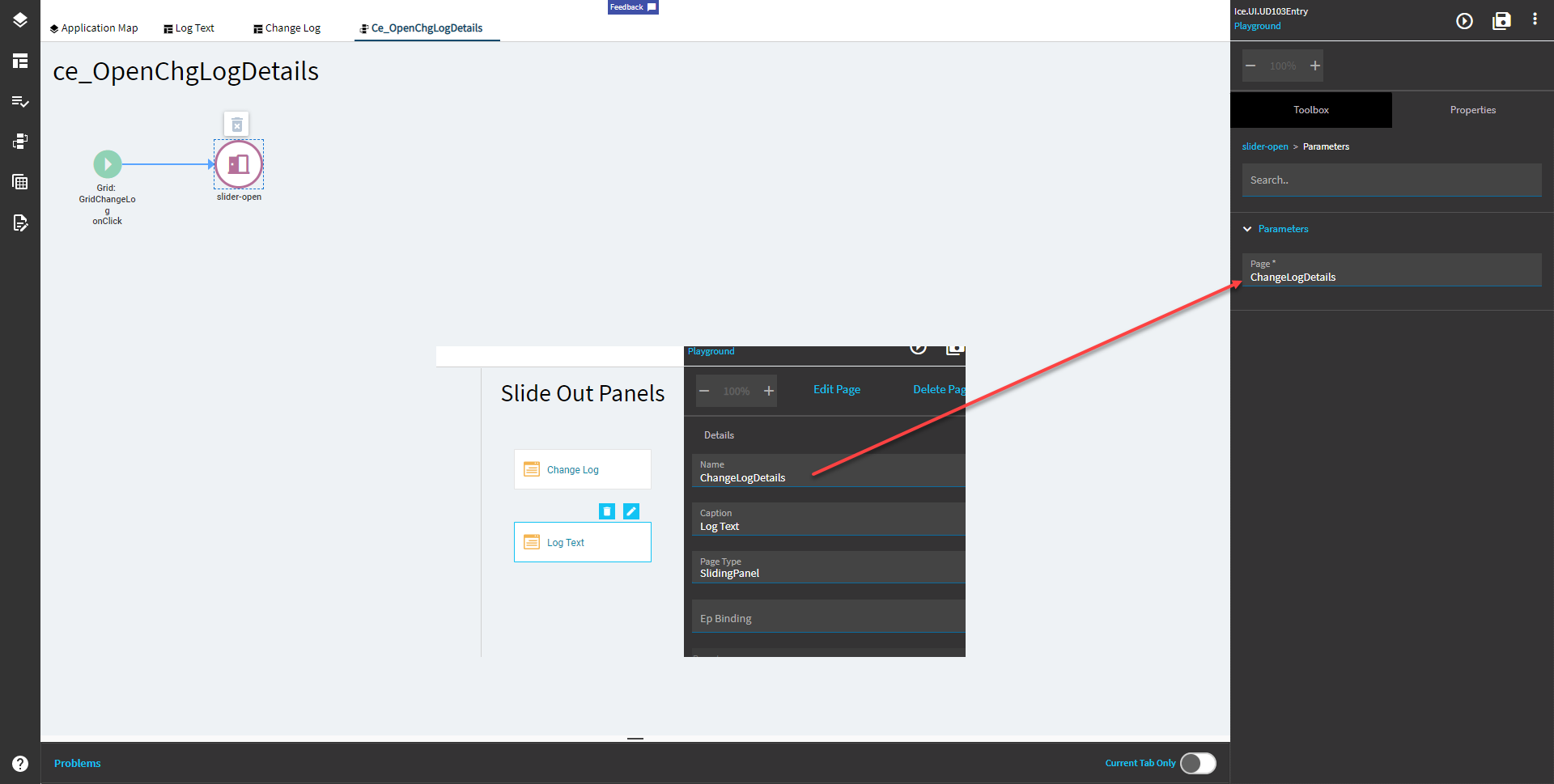

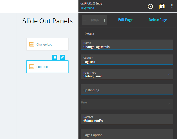

Add a slide-out panel for the details.
Add a panel card with a single column container and a multi-area text box.
Bind that text box to your DataView.LogText and make it read-only.
In the original slide out with the Change Log header info, go to the columns of the grid, select one, then mark Is Link.
Create an event with a trigger of Grid > On click. Set the Target to your Change Log dataview and the column to the one you made a link.
Add a slide-out widget and pass it the Change Log Details slide-out you just created.
And, by George, it does stuff! (I didn’t set the read-only property when I took the screenshot)

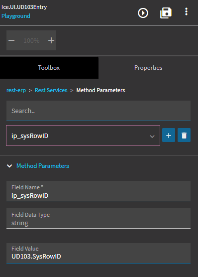

Yeah–that’s an issue. @josecgomez was just explaining this to me since I had the same issue loading the results of UD103.
So, the rest widget is looking for a SysRowID which… it ignores. :rofl:
It’s, instead, only looking at Key1, which may not be unique.
My recommendation would be to change up my steps a bit. Create a BAQ that loads the Change Log info, create a BAQ View in App Studio for it, and then use the erp-baq widget to populate your view by passing in Keys 1-5 or whatever is needed. The rest should be the same.
