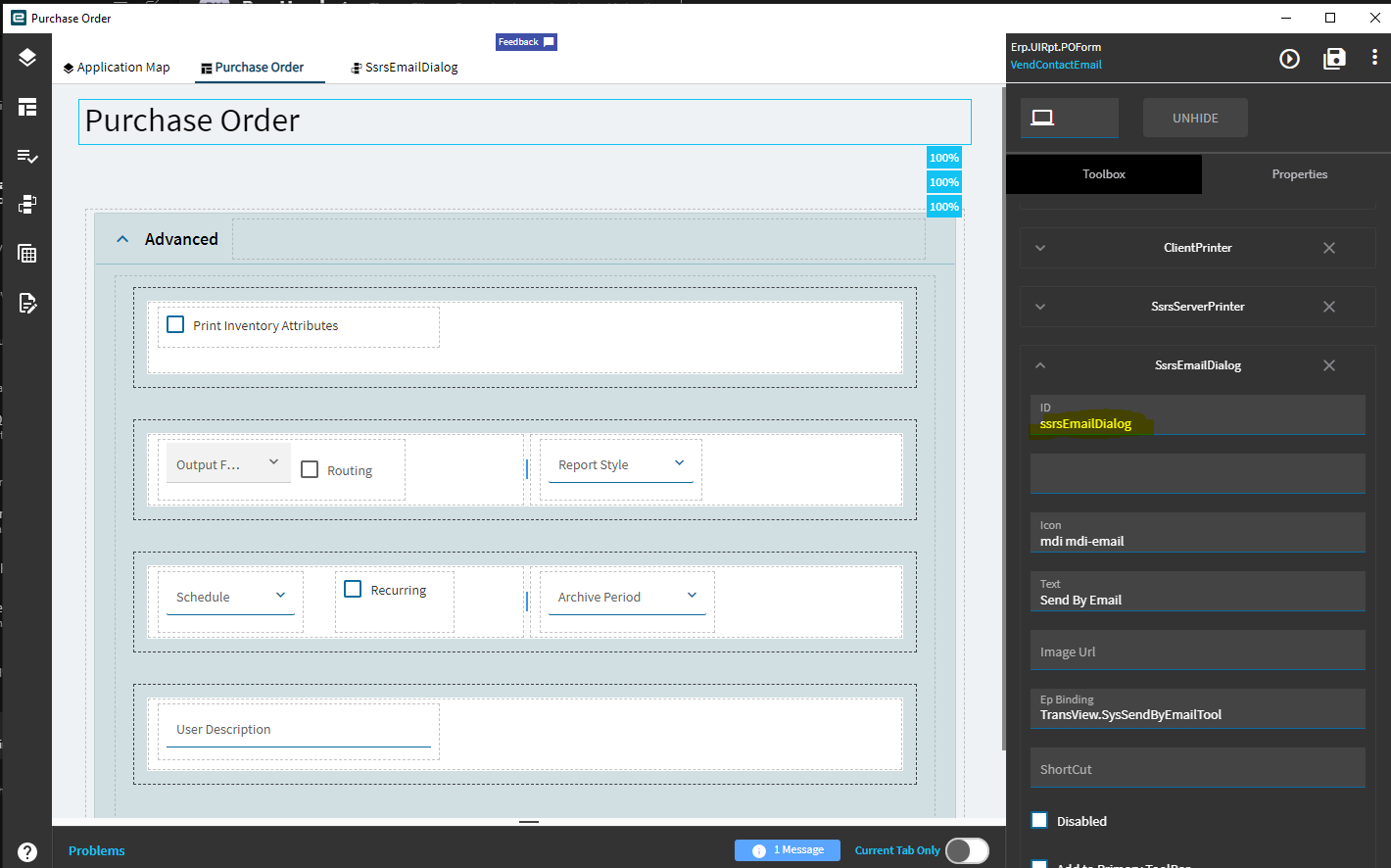

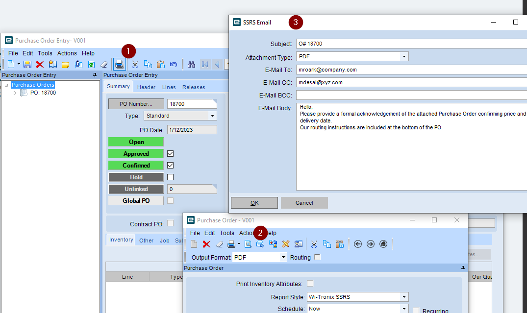

We are using this functionality since 5+ year in classic Epicor. When I try to simulate similar process in Kinetic, I can’t find the slider form to customize which map like classic .

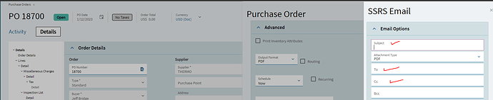

For quick reference, I am attaching both classic and kinetic view.
I can’t find any slider panel for PO Form Report in Kinetic- Which will open from eclipses … menu. also no library form available for this slider form.

You cannot customize global sliders like that.
@hmwillett Correct. In classic we have option to have multiple customization layer of lib form and call specific layer using process calling maintenance. I had one support call with Epicor-We can’t have kinetic custom BPM form - may be available in 23.1 or future. Thanks for update, if you find someway in future for this request, update me later. Thanks

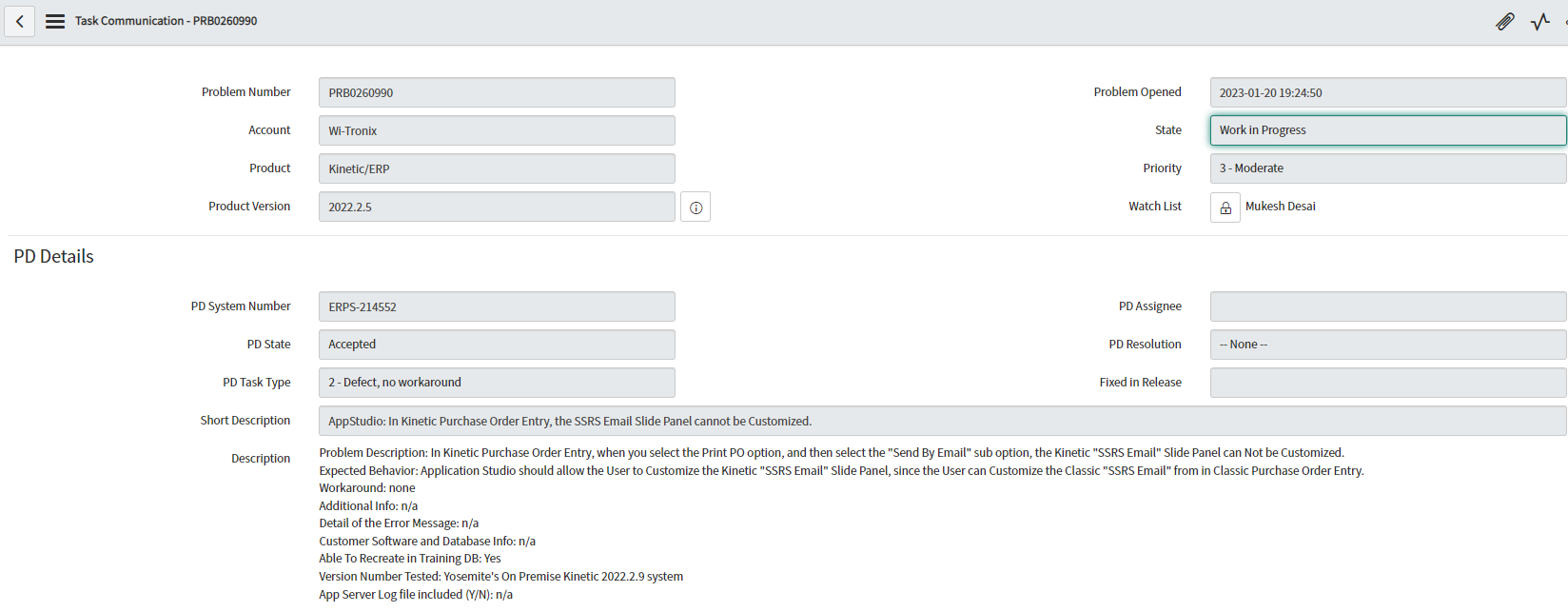

I had a support case and they entered problem case for my request. FYI:
I just verified from support case history that BPM form customization will be available in Fall 2023.2 version.
