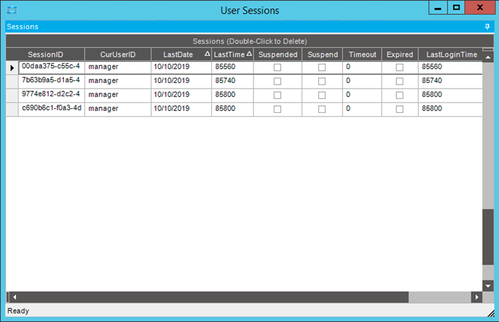

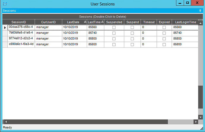

They can hit and hit kill session

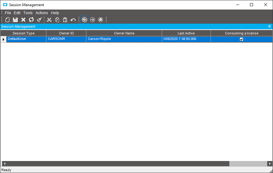

Session Management is available as a standard menu item in 10.2.600 (maybe before). You can delete a license through that. Of course deleting someone’s license causes lots of errors on the client that was open. I wouldn’t want to do that on the shop floor. Many people use generic logins for all the MES clients and leave them open.
Ah yes, @Carson is right, it is a standard menu item. If you wanted to filter it to be just your own user, you would need the do some BPM work. My screen shot was for E10.0
Not seeing it in our 10.2.400 deployment. Looks like it was added in either 500 or 600.
