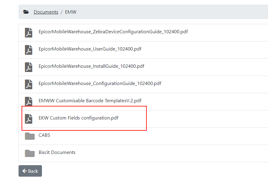

https://downloads.biscit.com/docs
Thank you very much!
Thanks Jose!

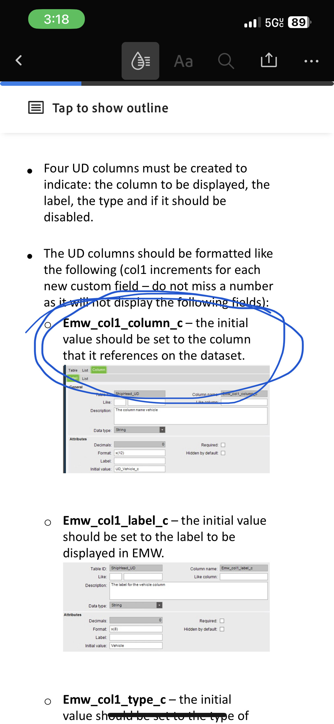

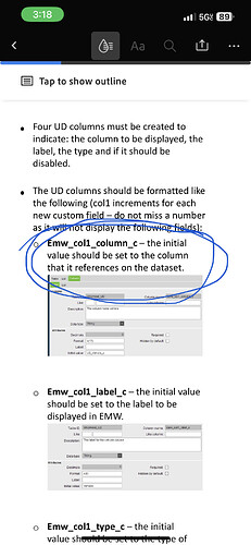

It doesn’t explain how to link to an existing field in the client, can you advise how this might be achieved?
Same way you still need to create 3 custom fields. ANd follow the same procedures.
Thanks Jose, I’ve done that however, I haven’t had to enter the field I want to populate?
You create 4 UD Fields the first field contains the name of the field you want to display (custom or not)
Look at the instructions on the PDF Carefully please it is all defined there.
Is the name of the field i would like to display to be entered into the column name field or initial value name field. I’m not finding the instructions straightforward.
