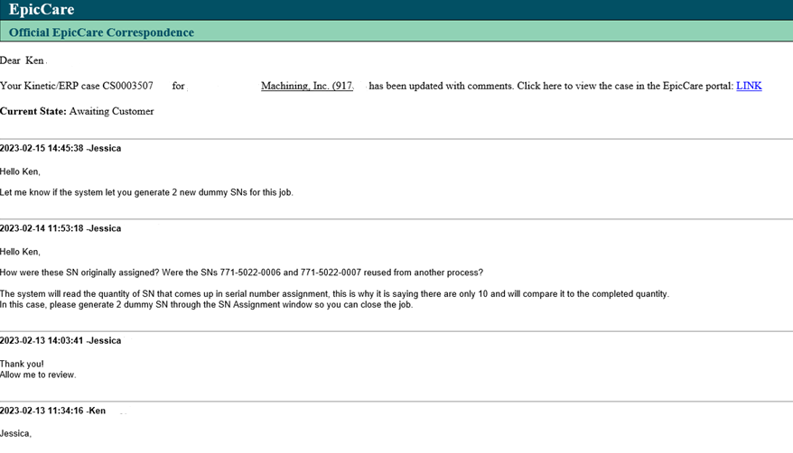

Hi @akhieu we had this happen to us once as well. The end result was support providing us with a Data Fix program. They discovered the serial numbers were not assigned correctly in the transaction. Below was their response to our case:
We have received feedback from DevSupport regarding the scenario reported.
There was a SNTran record for a Serial Number that was shipped and had a TranType of Unassign. That caused the count to be wrong on the quantity completed.
They provided a program file with the instructions to run it accordingly.
