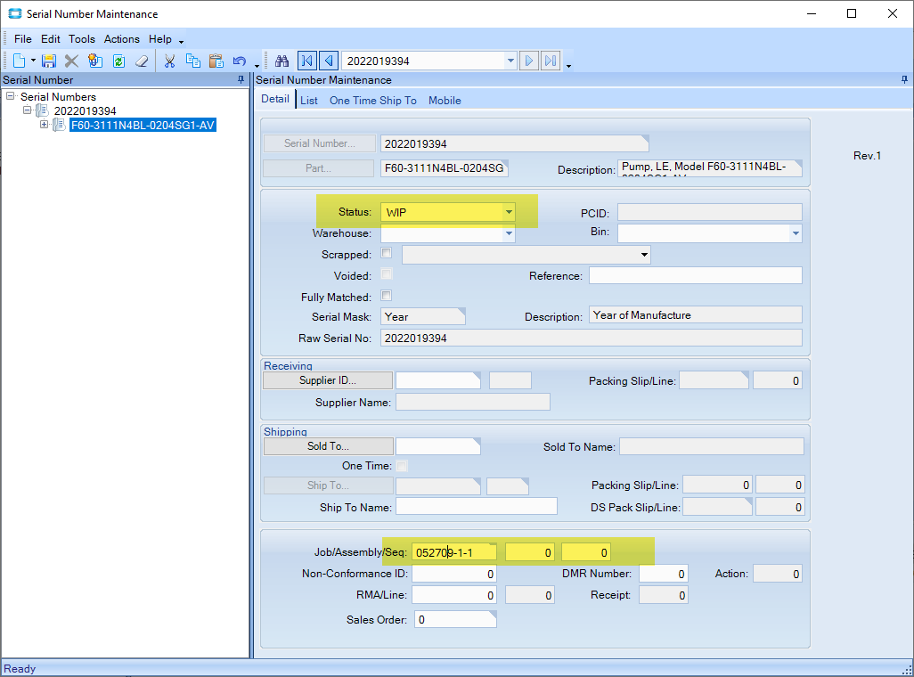

I have found that you can get the system to think it is assigned as usual by putting the SN status in WIP and also entering the associated Job/Assembly/Seq data into those fields in SN maintenance. When I tweak it this way, and go to job SN assignment, the SNs appear assigned in the grid. Have you entered the Job/Assy/Seq data in too in SN maint?

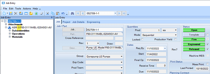

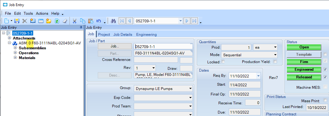

In addition to @Nancy_Hoyt 's suggestions, you can also change the quantity completed value for the job to match the number of actually assigned serials, and then close normally. The completed quantity is where the XX Serial Numbers required part comes from.
This works well if you do not use Job Completed Qty for other reporting or analysis ( we do not ).
