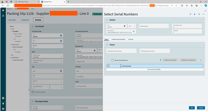

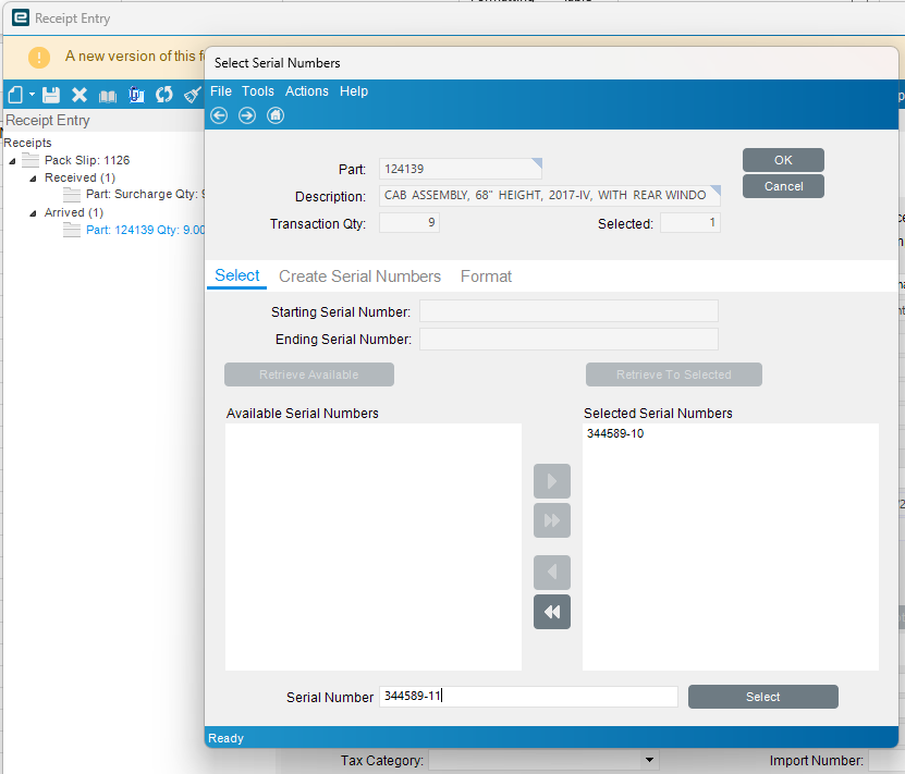

  6. Open Receipt Entry to receive them properly now
  7. And pause there…

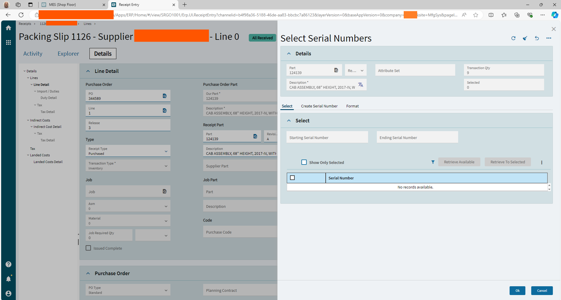

In classic, this works fine. You can’t “retrieve” the serial numbers, but you can enter them one by one and click “Select.”
But in Kinetic, I see no option to do this.

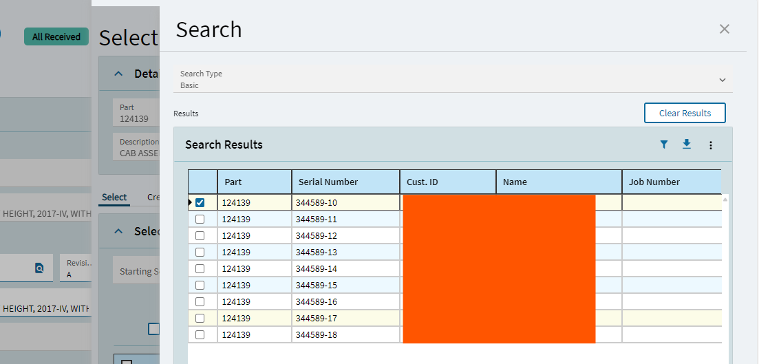

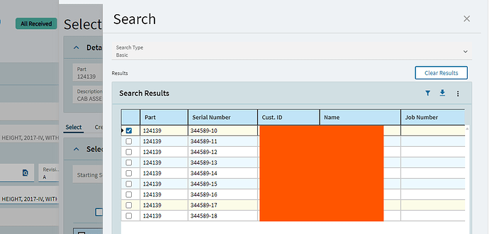

There is some kind of search, but it doesn’t seem to do anything.
Anyone ever receive “shipped” serial numbers in Kinetic?

It was a mistake (see OP). But since the serial exists already, you can’t use “Create New.”

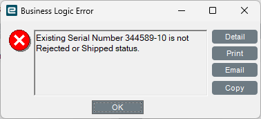

If I am remembering correctly, you could use either Adjusted or Unassigned.
Not Adjusted - and apparently it tells you the answer:
But regardless, Kinetic still don’t work.
EDIT: Ha, it does not like “Unassigned”!

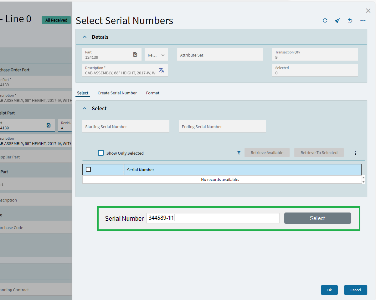

Support is saying (I think) that 2024.1 has restored the input box (thus fixing the issue).
So like this I guess:

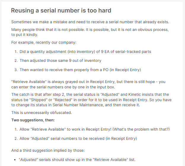

Idea created:
Reusing a serial number is too hard
