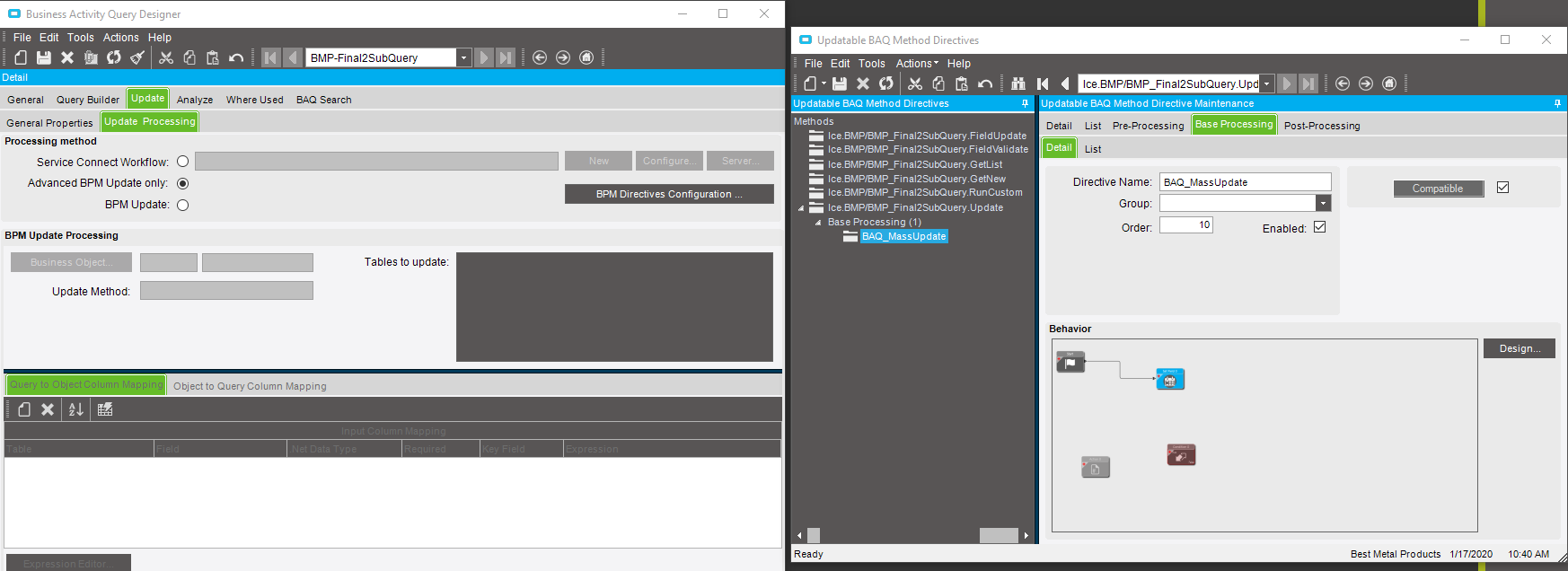

I am using a BPM to try and update a checkbox field in the DB. I am not experienced with programming so I was hoping to do this with the tools epicor provides. When a checkbox is checked on a dashboard, I want the checkbox to set to true in the OrderHed_UD table. Given the tools epicor provides, I am only able to set the values of the tt table. It was my understanding that after the tt table was set, it would then write the differences into the DB. However I am not seeing any changes on the table. I am looking at the table through a query that I wrote to look at the particular order I am dealing with. I know the BPM is firing as I put a simple message box to test if it was, and the message box fires everytime.
This pic is what I currently have setup. Any help would be greatly appreciated, thank you all!

From your picture, it does look like you may be doing the updatable BAQ already and attempting to use BPM’s on it’s methods. Is this the case?
Yes I do have a updatable BAQ dashboard setup.
This screenshot might help to clear up a few things! I am very sorry for the confusion. I am a total epicor noob who got thrown into making this work.
So from my understanding, it’s an updatable BAQ dashboard, and then on the Update method I am trying to write to the checkbox.

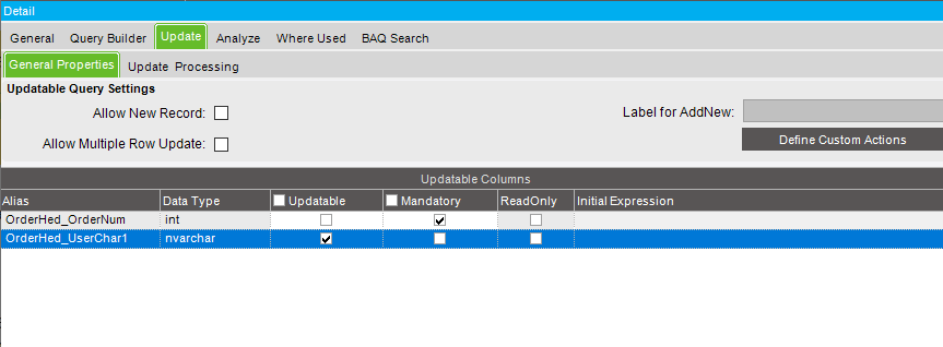

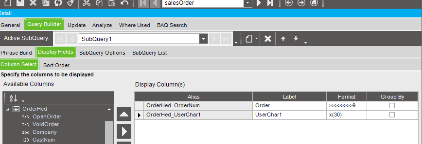

For your case, since you are updating on the OrderHed table, you will use the SalesOrder BO and it’s UpdateExt method you had mentioned before. In order for the ubaq to know what record to update, there will always be key/required fields that must be included as display fields. In this case it just needs the OrderNum to be included. Here’s a pretty simple example that will update UserChar1 on the Erp.OrderHed table:

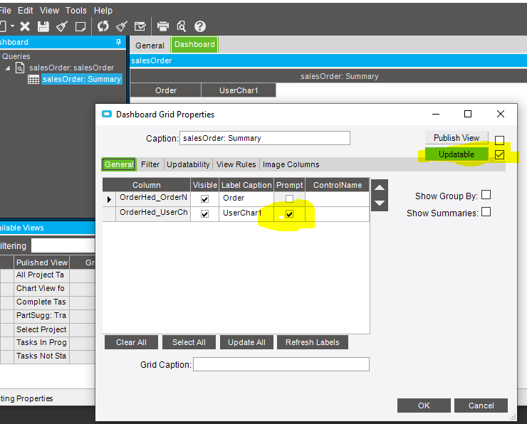

For it to work in a dashboard, there are a few boxes you’ll need to check:
