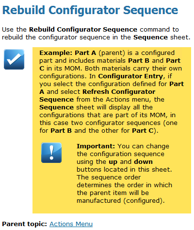

  1. did you run the Configurator Entry/Actions/Rebuild Configurator Sequence?
  2. have you checked the Sequence Tab in Configurator Entry?
@timshuwy , we have rebuilt the configurator sequences, but it is still not working.
