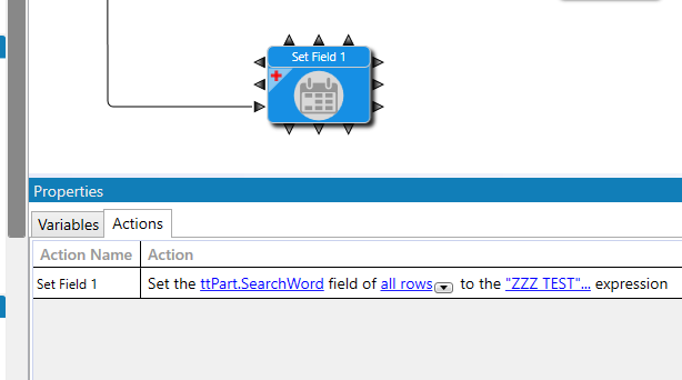

I am trying to set a field value when a user copies (Duplicates) a Part and it won’t work. I tried both a pre- and post- processing Directive on Part.DuplicatePart. Seems like it should be easy.
I have searched the issue and it seems like others have struggled with this same problem but I didn’t find any specific answers. There was a coding work around. I am just trying to use the ‘Set Field’ widget and nothing else. And not a custom field either, just setting PartDescription to ‘ZZZ TEST’ and it does nothing. I know the method is firing because I inserted a Show Message widget and that gets hit.

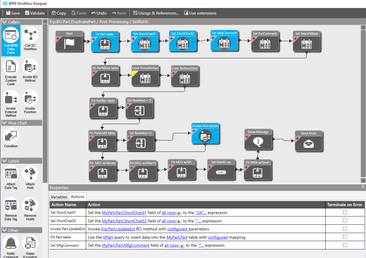

I think a pre-processing directive occurs before the new part record is actually created, and a post processing directive is too late to change anything. So, in my DuplicatePart post processing directive, I have to first fill a table with the new part record, then set the fields the way I want, then Invoke Part.Update BO.
I am also deleting rows from the part revision table and formulating an email to send to production/purchasing which make this look more complicated than you need just to change a few fields. The 5 widgets highlighted may be all you need.

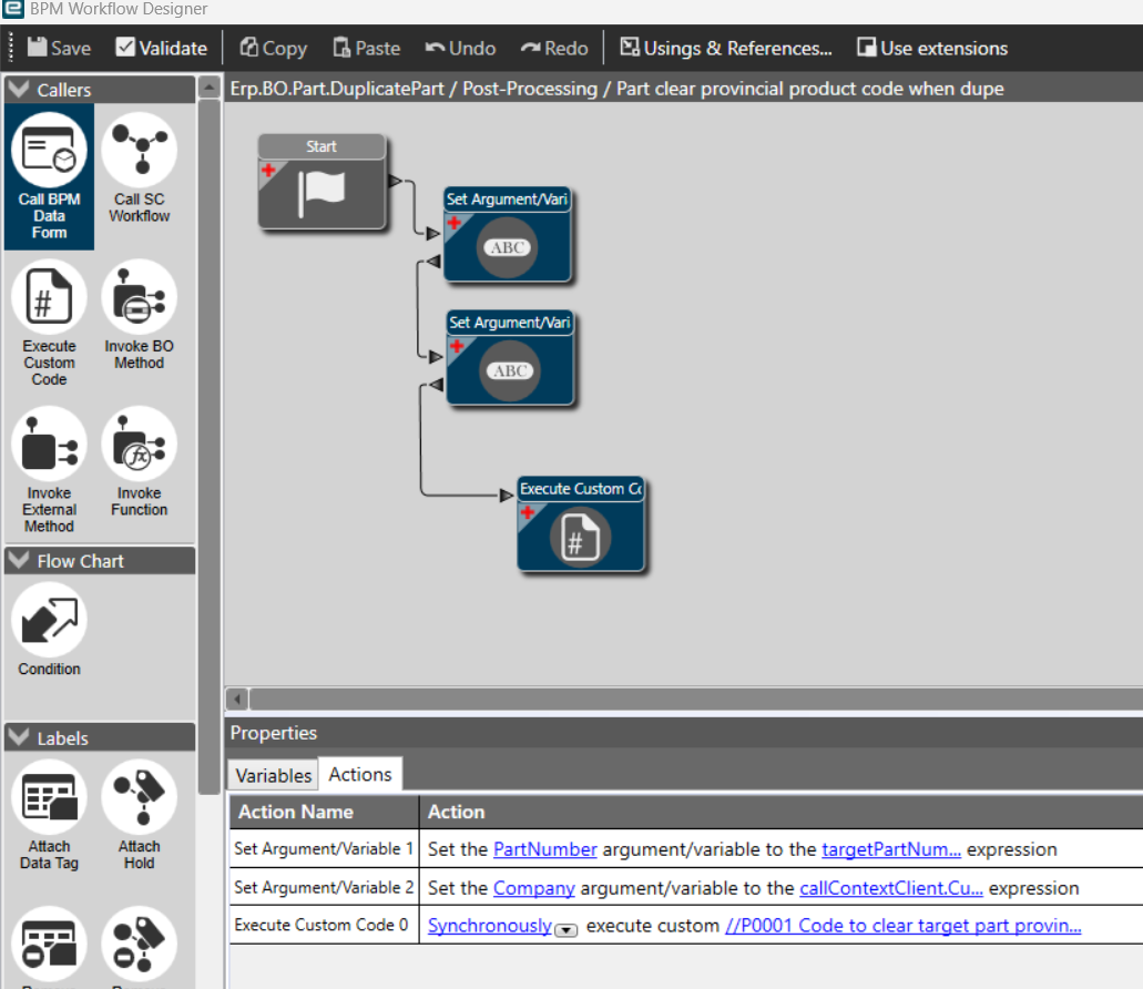

But I found a solution. It involves a very small piece of code
  1. I created 2 variables Company and PartNumber - both strings
  2. I set the PartNumber variable to the targetPartNumber Parameter
  3. I set the Company variable to the callContextClient.CurrentCompany
  4. Then I wrote a very small piece of code
foreach(var PartRow in (from row in Db.Part.With(LockHint.UpdLock) where row.Company == Company && row.PartNum == PartNumber select row))
PartRow.ProvincialProductCode_c = “”;
There are likely more efficient ways of doing it but after an hour of trying to set it with the field widget I will take it.
