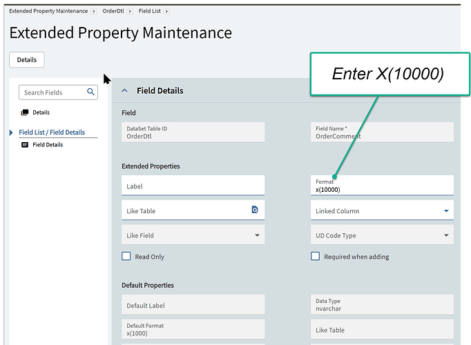

Just modify the extended properties?
So to fix this for the time being is:
What could the down side be?

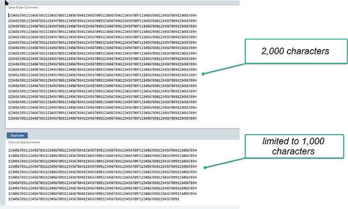

The testing shows
The fix is to change it to x(9999) or however many characters you need in extended properties. Working fine for us.
