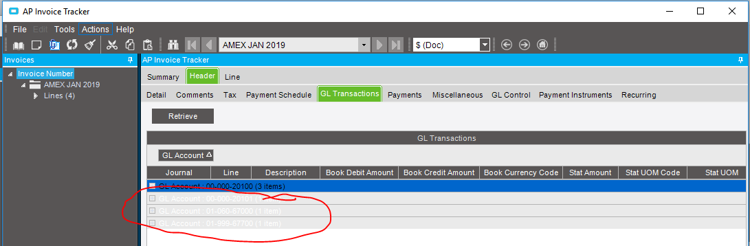

Can someone tell me what needs to be edited in the theme to change this color circled in red in 10.2.300.7? This white color is not very visible.

Looks like the Michigan Snow Colors - You Themed it for the Season bright?
Looks like they even messed up the Grouping Section from the usual Light Blue.

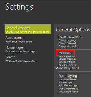

Edit - I had a theme applied under Settings > General Options > Preferences > Theming tab. Once I deleted the theme name so it was blank, it worked on the next login. Fixed!
