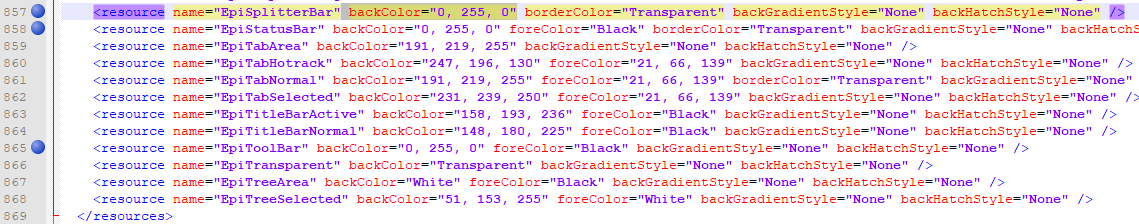

Editing a them and saving the changes to an ISL file does nothing but make that file. You then have to go into theme maintenance, and re-import the ISL for that theme.

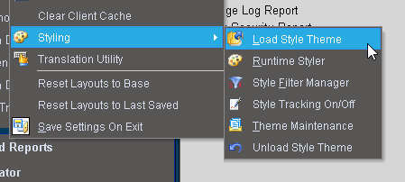

Loading a Style Theme, like:
Only loads it for that session.

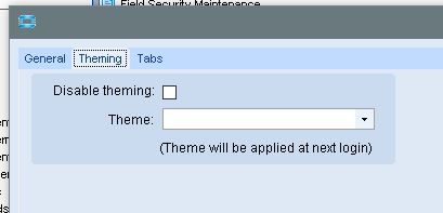

If the them you marked as default in Theme Maint, does apply when the session starts, make sure the Theme selected in Preferences → Theming is blank.

Try just loading the ISL with “Load Style Theme”. Does the expected change show in your UI?

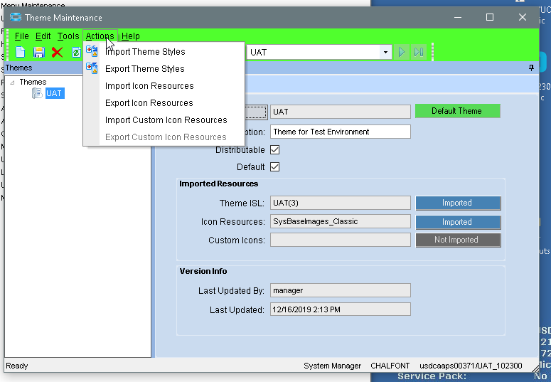

The Theme Maintenance window on my Test Environment looks like:
The main thing for that theme is the lime green menubar coloring.

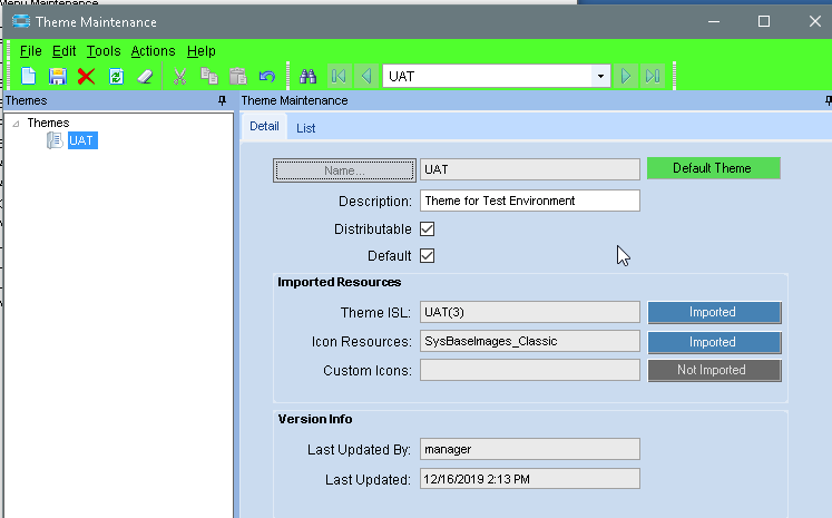

Note that the Theme ISL value is UAT(3).
I searched on my workstation and found a lone copy of a file named UAT(3).isl. With the E10 client program closed I renamed that file, then launched the client. The theme loads fine. Proving I don’t need a copy of the ISL file on my local machine.
Next I searched the App server for ISL files, and did not find one named UAT(3).isl So the Theme ISL value on them Maintenance must just be the name of the file that was imported, and not a reference to it, to be used to load the theme style each time…
