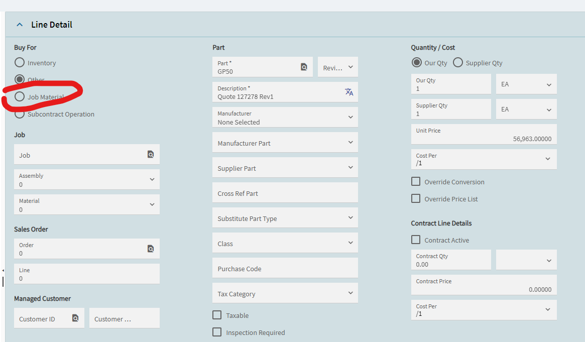

Changing PO "Buy For"
Is it possible to somehow change the “buy for” from “Other” to “Job Material”?
I am setting up jobs after the PO has been generated, would like to tie them to the specific job, but it’s grayed out on the PO.
Do I have to create new line items, then delete the old? If so, that really sucks.
It’s soooo frustrating hitting brick walls when you have to make a change to something in Epicor.
Hopefully I am just missing something stupid and I can unlock the grayed out stuff and change it?
is the quantity bearing checkbox checked in part maintenance?
If the PO is closed, you need to reopen the whole thing (Header, Line, and Release).
Additionally, if it is approved you need to unapprove it.
I don’t actually believe that Epicor lets you change it.

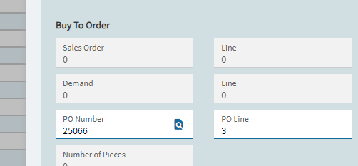

If the PO is still open you can Enter the existing PO on the PO Suggestions slide out screen.
Select Buy and Generate POs. It then creates a new Release on the existing PO so they are linked. Remove the original release after you’re finished.
