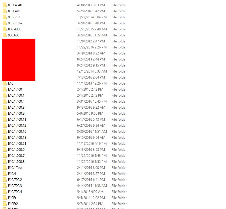

You can have all the client versions in the world my friend… Just stick them in a different folder
But I have to manually do that, no?
And where do you have those (Directory Tree -wise)?
My workstation’s client files are in C:\Epicor\ERP10.1Client\Client
So I should :
  1. Rename C:\Epicor\ERP10.1Client\Client to
    C:\Epicor\ERP10.1Client\E10.1.400.19
  2. Copy C:\Epicor\ERP10.1Client\E10.1.400.19 to
    C:\Epicor\ERP10.1Client\E10.1.400.23
  3. Update mys Live compay shortcuts to use ...\E10.1.400.19\config\Live.sysconfig
    and ...\E10.1.400.23\config\UAT.sysconfig
Sound right?
That should work, epicor client is confined to its own folder so you can put it wherever you want as each CLIENT VERSION needs to be in its own folder

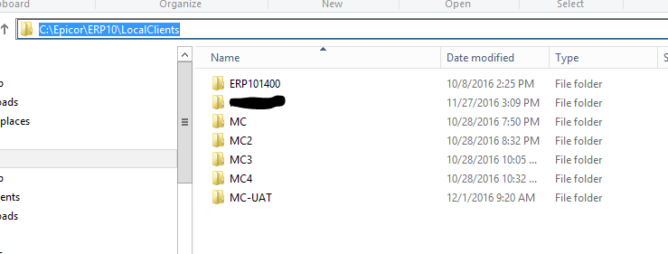

  1. Make sure to use alternate client cache.
    By default, all users share the same client cache location. On a shared machine, the alternate client cache should be used to “unique-ify” the folder structure so every user has their own cache folder. We allow the use of Windows global variables so you can make the cache folders unique per Windows user which is my preference. This will avoid a number of issues; trust me.

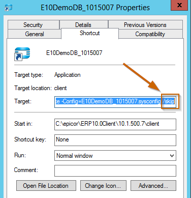

  2. Autoupdate should be disabled for all published shortcuts for users who aren’t local admins.
    In 10.1.600 we are planning a rewrite of the autoupdate process to not require a user be a local admin, but, even when that happens, this recommendation would still hold in this use case. Autoupdate can’t succeed when there is any user who has a client session launched on that machine and in a RemoteApp/RDS server situation, the autoupdate can’t/won’t force all of those sessions to terminate on that server.
    NOTE: there are ways around triggering the autoupdate without being a local admin, but, it involves disabling UAC and some other less than ideal security changes on the server so I really wouldn’t recommend trying to work around it.
