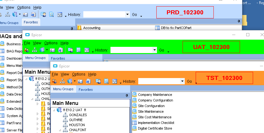

One thing I always do, is to make an Environment specific theme and set it as the default
The Green and Orange really standout to let people know they’re not in the live DB
And that color appears on all forms.
Here’s the ISL file for the green one.
UAT.isl (33.3 KB)
That’s pretty cool. We have multiple Companies, so I use a different color scheme for that oft-occuring situation. My users are rarely in multiple environments, although I encourage the use of Test. And no one wants to spend any time in Train - we’ve customized heavily, so much of the basic training material in not applicable.

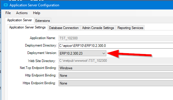

A ,23 to .28 update doesn’t change everything on the app server. And you can have the different Apps/environments running at different .xx versions. You choose the version in App Configuration
So it is quite possible (and normal) to have app PRD running on 10.2.300.23, and app TST running on 10.2.300.28.
Yep. totally understood. I belatedly understood your intent to run different versions.
