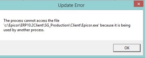

We ran an update to a patch 10.2.500.27 and we are intermittently getting an error where it says that Epicor.exe is in use (when it clearly isn’t)
During the upgrade process (at the end)
We can break it pretty much on command by calling /update on the shortcut and it will do it once every other time or so
I’ve done a lot of testing and I believe it is a timing issue. That is the Epicor.exe from the patch is copied in and immediately it tries to access it but it can’t

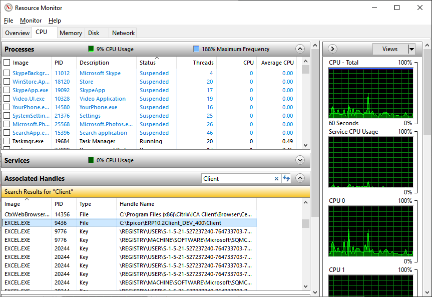

I printed an SSRS Report to Excel, I left that report open overnight, so today I forgot I still had /Update and it failed… I couldnt even rename the Client folder, so trying to figure out what in the world is still having a lock on it (I closed everything)… turns out Excel.exe left a lock on it… PERHAPS Because it was launched as a sub-process (Open with Excel, SSRS to Excel).
Maybe your issue too… Nontheless make sure you close all your files :slight_smile:

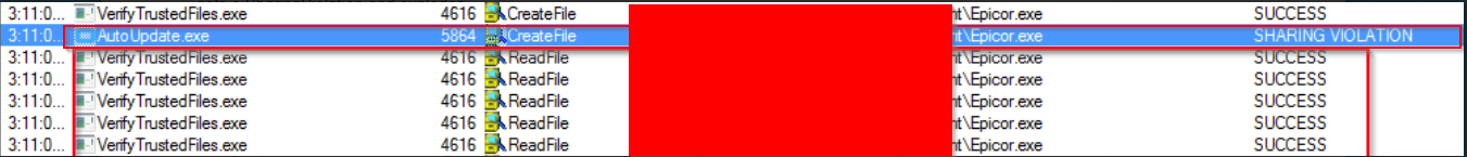

At last!!! thanks to SysInternals tools and (Mark Russinovich MCM :heart_eyes: frigging genius that guy) I was able to find the culprit.
One of our security systems (via Manage Engine) uses a tool called “VerifyTrustedFiles.exe” which is supposed to monitor executables and do some crap I don’t know.
Anyways thanks to Process Monitor I was able to see that AutoUpdate.exe copies Epicor.exe (from the latest patch we were installing) successfully
Then VerifyTrustedInstaller immediately opens that file and starts snooping around (as it should) but it creates a write lock on the file.
AutoUpdate.exe then tries to (again) open Epicor.exe to launch the program or who knows why and it gets a SharingViolation and explodes.
Fix is to disable this feature or add Epicor.exe to an exception list.
