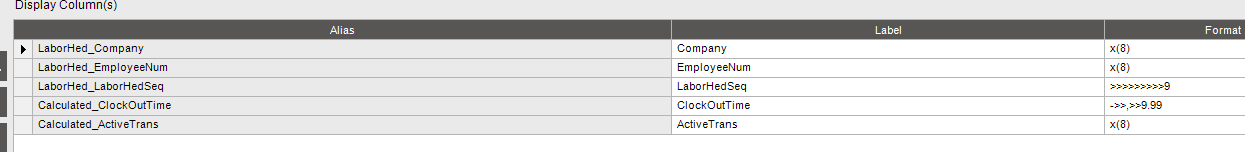

The following post demonstrates using Powershell to generate a list of employees that need clocking and then fires DMT to clock off the users in the list
Thank you! This is a great idea, I’ll give it a try and see if I could get it working.
@jgiese.wci I know this is an old topic, but do you mind helping out a complete novice?
I imported your BAQ (after fixing version compatibility - I’m on 10.2.700.24) and when I check the syntax of the BPM code, I get the following error:
The name ‘BetterLog’ does not exist in the current context
Is that something I need to create or reference? I did notice a UD field as well (MissedPunch_c) that I could create later, but for now I’ve simply commented that line out to test.
