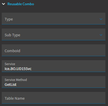

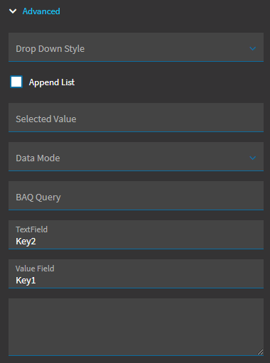

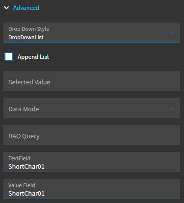

I just got a combo working with a UD table using reusable combo:
Screenshot 2024-05-30 164525
Maybe that can work for you?
I also could not figure out how to get it working from a dataview…
