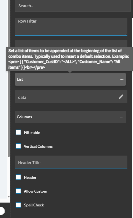

I’m working on a Kinetic Dashboard and wondering whether it is possible to add an option for ALL or NONE in the drop down list. For example, I can filter list of Parts and select a particular Part Class, but I have not been able to figure out how to add an option to filter for records where no Part Class has been set. I’m using the Reusable Combo type for this one. I have another combo box being populated using the UD table type that I would like to be able to do the same thing with.
See my setup in Erp Editor Model:
When you hover over “List” the help info seems to indicate this is possible.

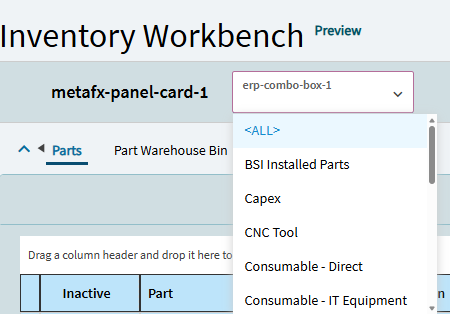

So I belive the append list configuration in AppStudio seems broken. It works for combos having Display/Value arrays but not for reusable combos that have other fields like Description/ClassID in your case.
You should be able to simply add to the list like so, but it adds a blank value to the top of the combo list.

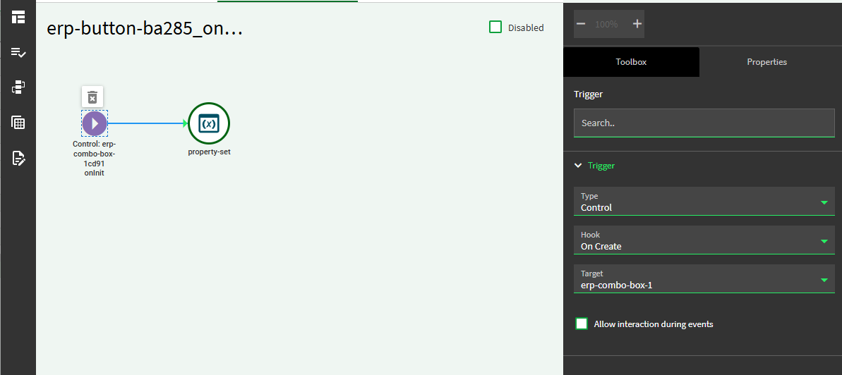

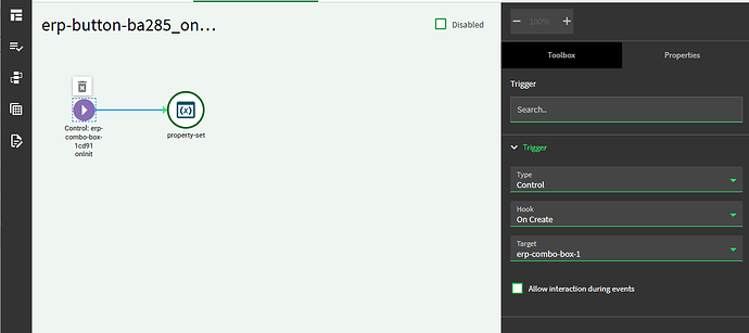

You can use property-set action to write your append list directly to the combo.list property like so:
Trigger on combo.onCreate
then property-set combo.list
value:
		"Description": "<ALL>",
		"ClassID": "ALL CLASSES"

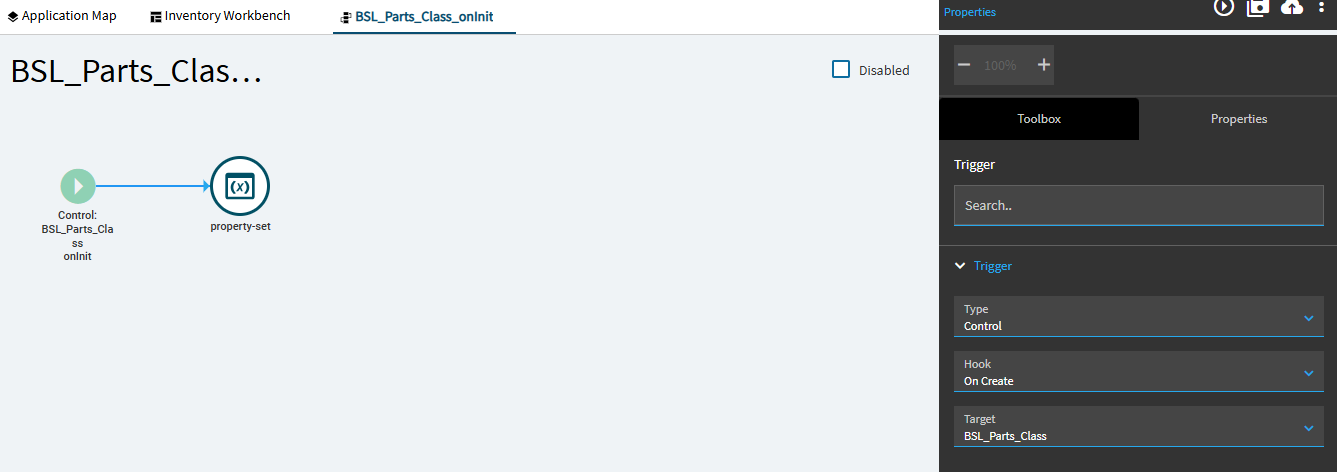

I haven’t had much success with grid Editor Models. What you’ve done looks correct. One important difference is that the control may not be rendered until the row is selected.
You’d think onCreate would handle this but I suppose I’d start by proving the event is indeed firing and when.
That will tell you if it makes more sense to scrap the Reusable combo and go with a BAQ which includes your ALL option.

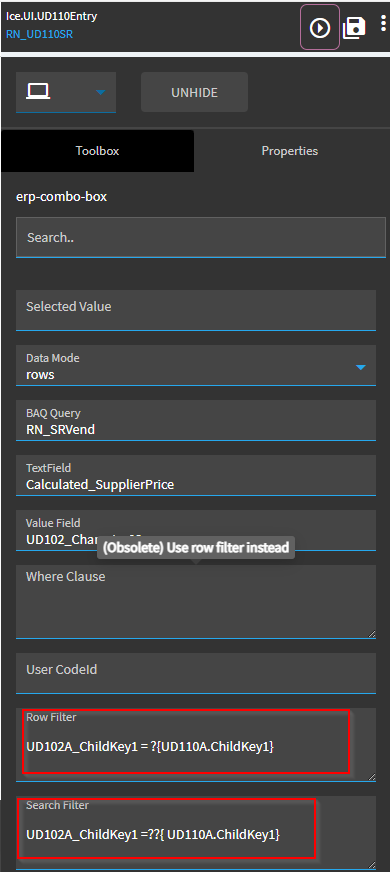

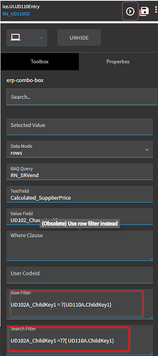

These are my settings for a combo box that displays a list of rows from UD33 filtered by different field (OrderDtl.PartNum that corresponds to UD33.Key1):
Reusable Combo settings
a) Service > Ice.BO.UD33Svc
b) Service Method > GetRows
c) Filters > Key1=’?{PartFilter}’ (PartFilter is an arbitrary name for filtering purposes only)
d) Filters Params > PartFilter=?[PartNum] (here PartNum defaults to current table which in this example is OrderDtl)

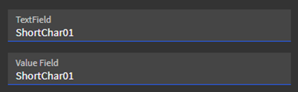

For Advanced settings
a) TextField > ShortChar01
b) Value Field > ShortChar01
Thanks - yeah I can’t see any Events firing when you click on drop down for grid column or select a row. I think I’ll try the BAQ option and see if that works.

How do you find the Service?
It should follow the format in the example above, depending on the UD table.
