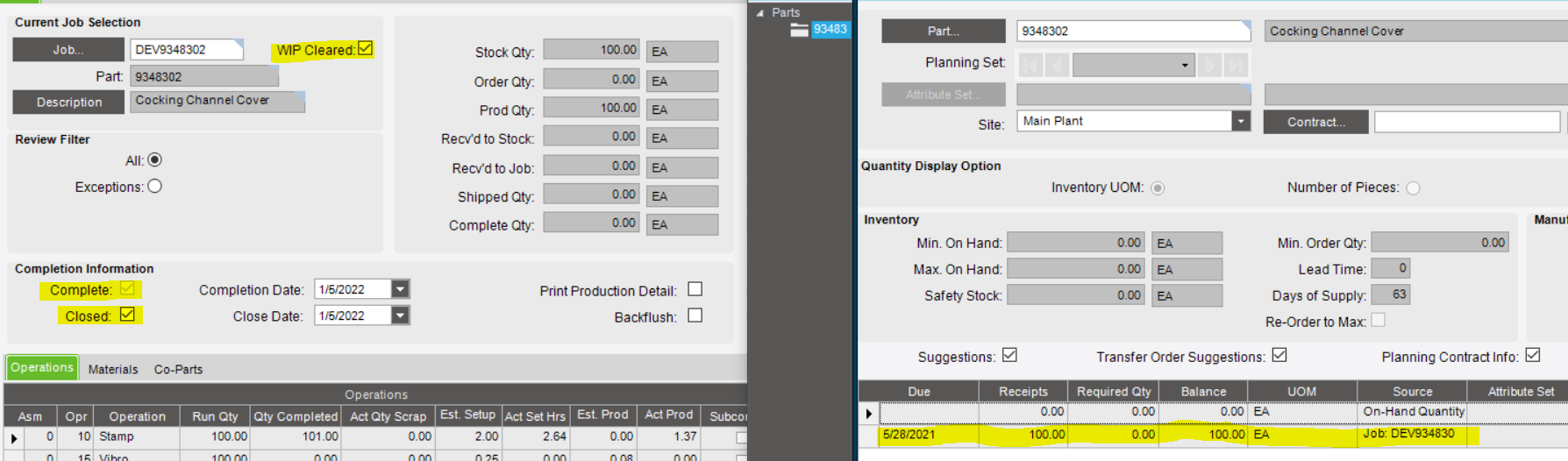

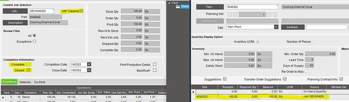

I am having multiple instances where a job is completed and closed in Job Closing, but is still showing up as demand in time phase. I have looked and WIP is checked cleared, all material was issued, everything myself and the team can think of is done. The only consistency between the jobs is that they are all attached to a project, though different projects. I can send in the required rows to Epicor tech team and get a data fix, but why is this happening? Is anyone else seeing this?

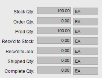

What did you do with them? Your screenshot shows they were not received to Stock or Job and were not Shipped. Also, 0 were completed.
This was a development job. The parts were made on the first operation, so RM backflushed correctly, but the parts were not good so nothing was done on the rest of the job and it was closed short. This happens frequently on Dev jobs.

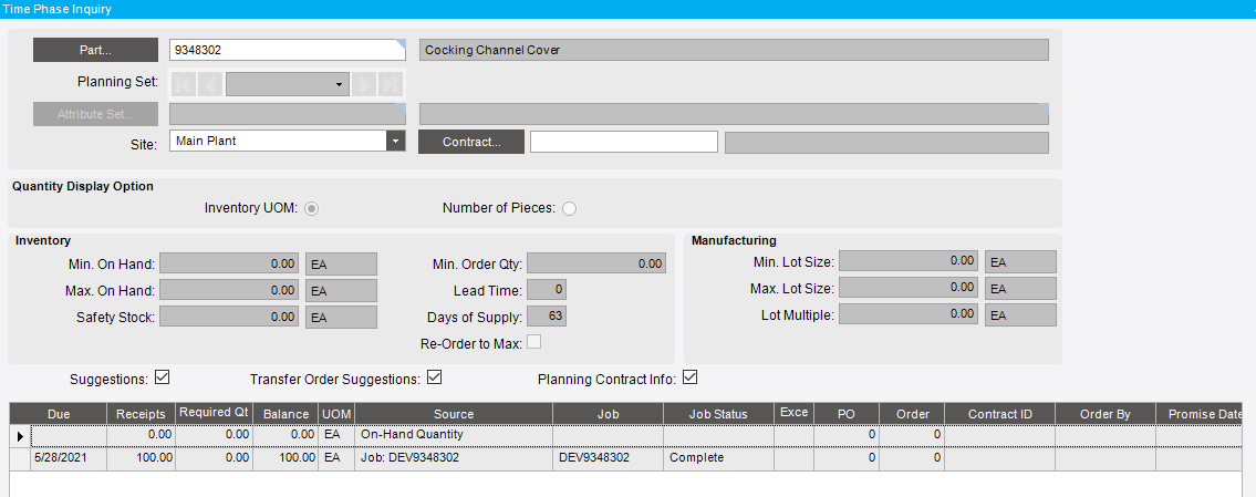

Can you do a screenshot of all the columns in Time Phase?
Is there one in particular that you are looking for? These are the only ones that have any data in them.
Thanks, that’s perfect.
That line is for supply but there is no demand. I do not have an answer but I do have a couple of things to check.
