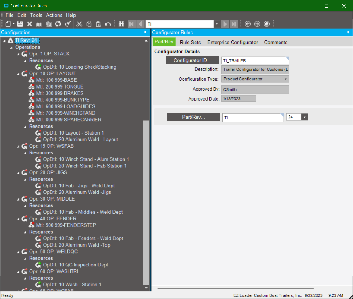

Hi Austin,
Since you want a configured part with its method stored, do you want to just make it a part in the part master with an associated revision and method/bom?
We do that with ours, per highlighted below. We are not on kinetic configurator however; ours is based on E10.

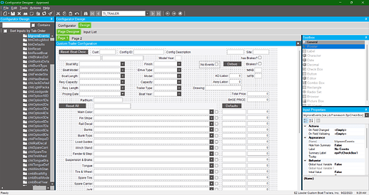

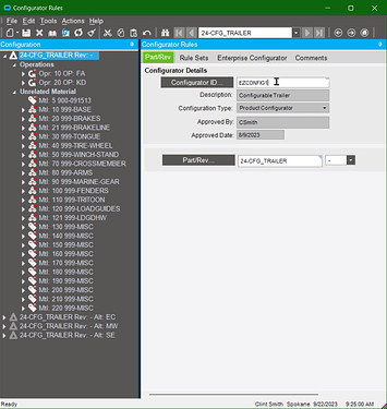

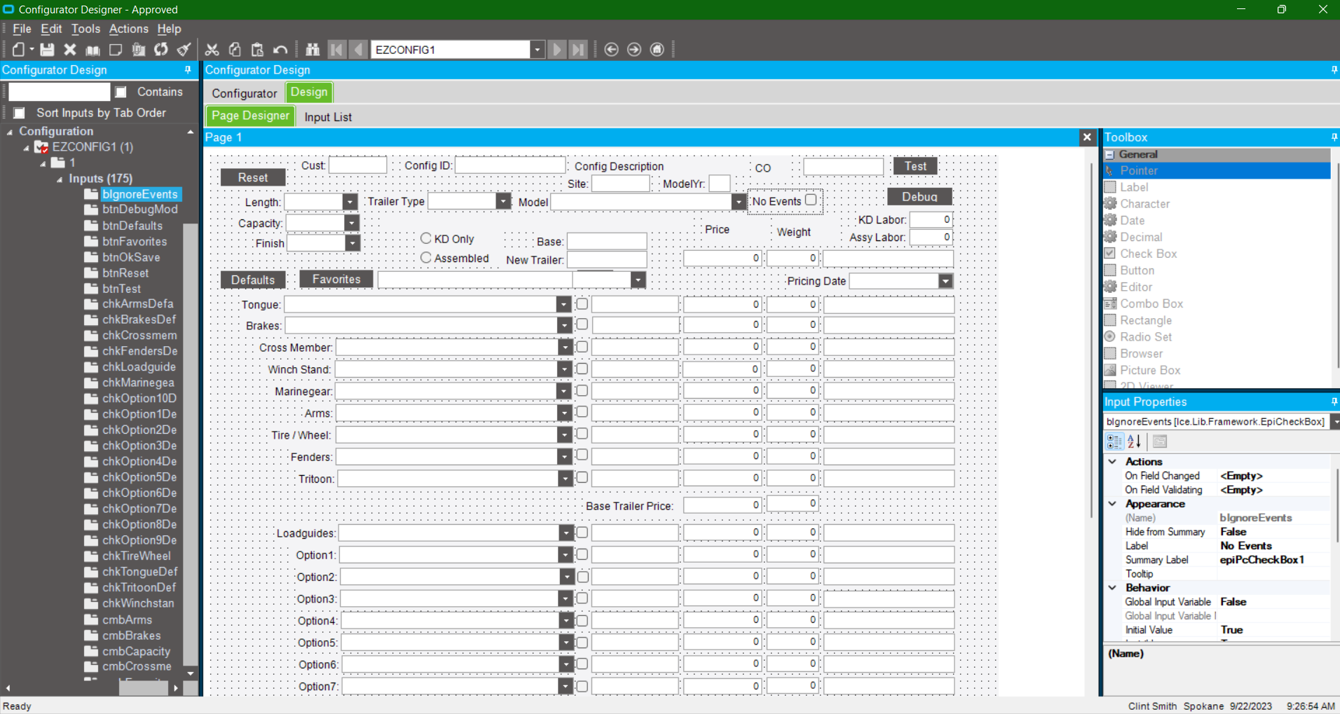

@Steen we use a master MoM for our configurator(s) each division has similar structure and breakdown.
Custom Division (Master Part) looks like this and is variable for aluminum vs steel product:
Designer (fields filled from BAQs/to find base trailer then options filled based on that):
Adjustable Division (Master Part) looks like this and is variable based on depth of assembly (kit vs full assembly) and Site (see alternate revs):
There are lots of rules :smiley:
Bottom line the configurator is extremely flexible just need to find best design of MoM to fit your company.
