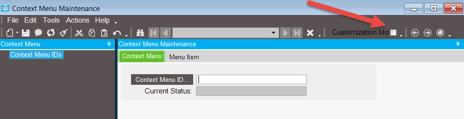

Be careful, there are three two modes in context menu definition a personal and customization mode. Just like form personalization and customizations. After deleting, be sure to exist-logout and login again. Before defining your menu context check customization first:

  1. Open Context Menu Maint & enable Customization Mode

  2. Enable customization mode
