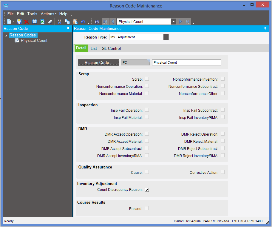

Are you sure you setup the Reason Codes under the correct reason type?

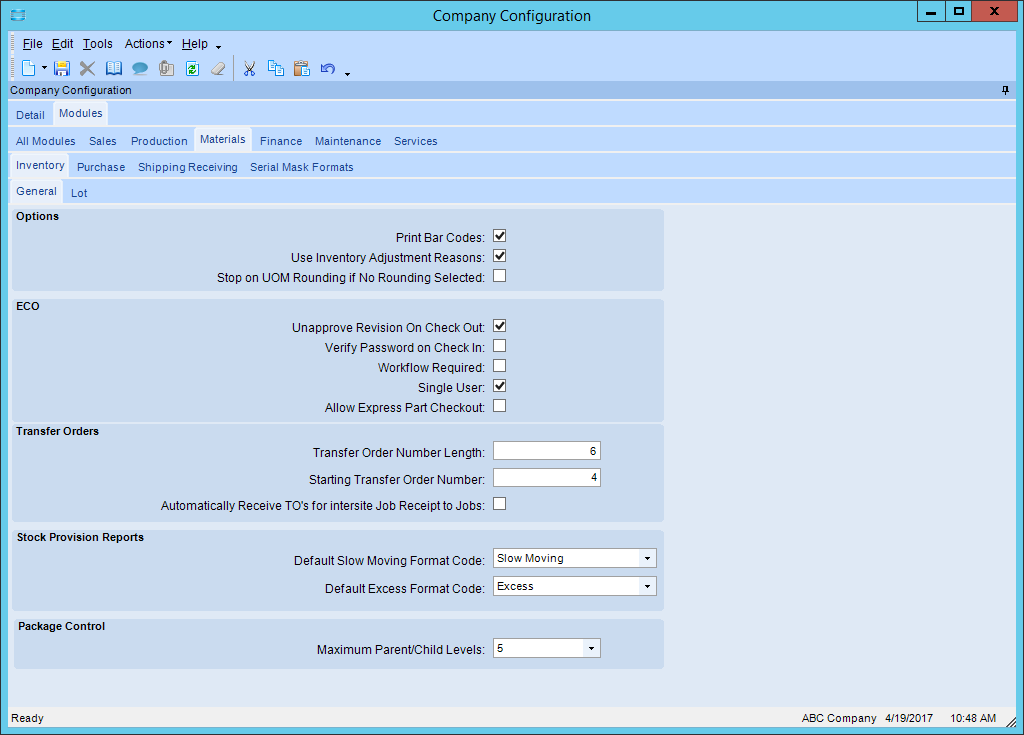

Do you have Use Inventory Adjustment Reason Codes checked on your company
configuration?
