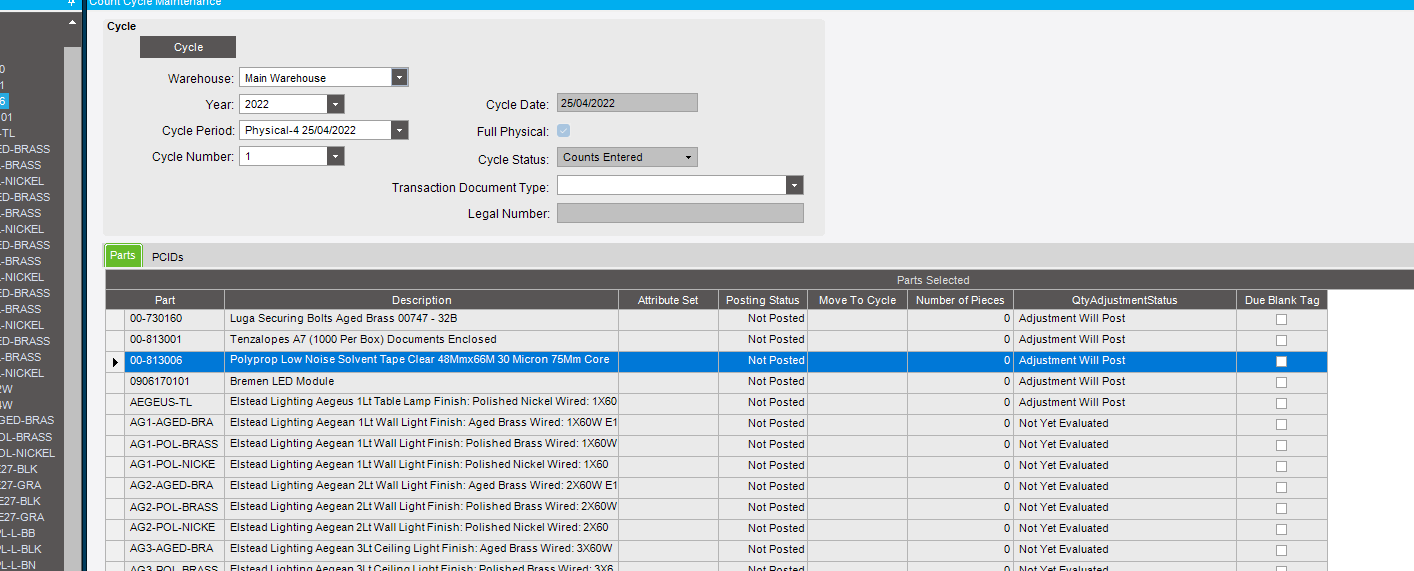

Hello, I ran the physical inventory generation and created the tags I have scanned 5 as you can see bellow but it wont let me post the adjustments not sure what i am missing
it says this

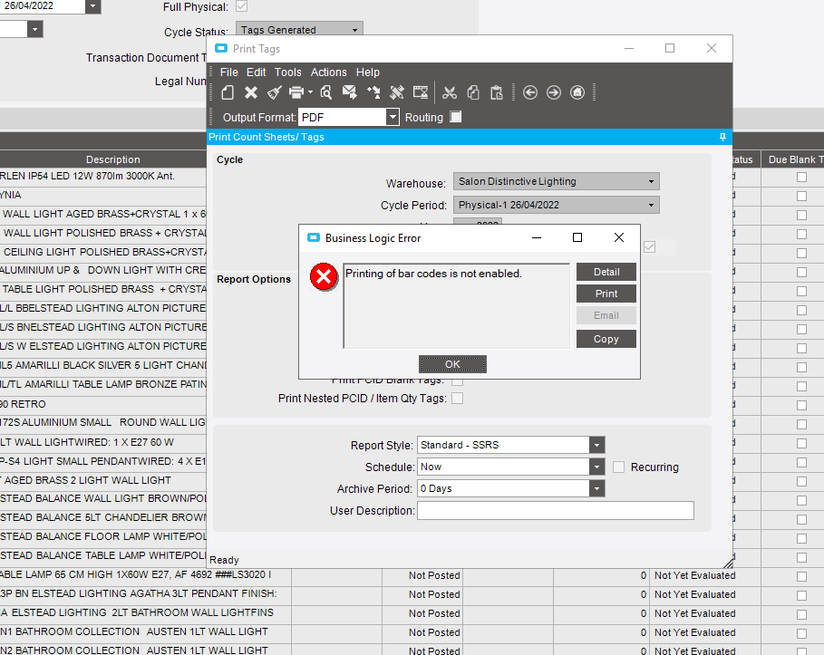

I do have another question how can I get a scanable tag barcode on the cycle count sheet there is an option but i get this error
