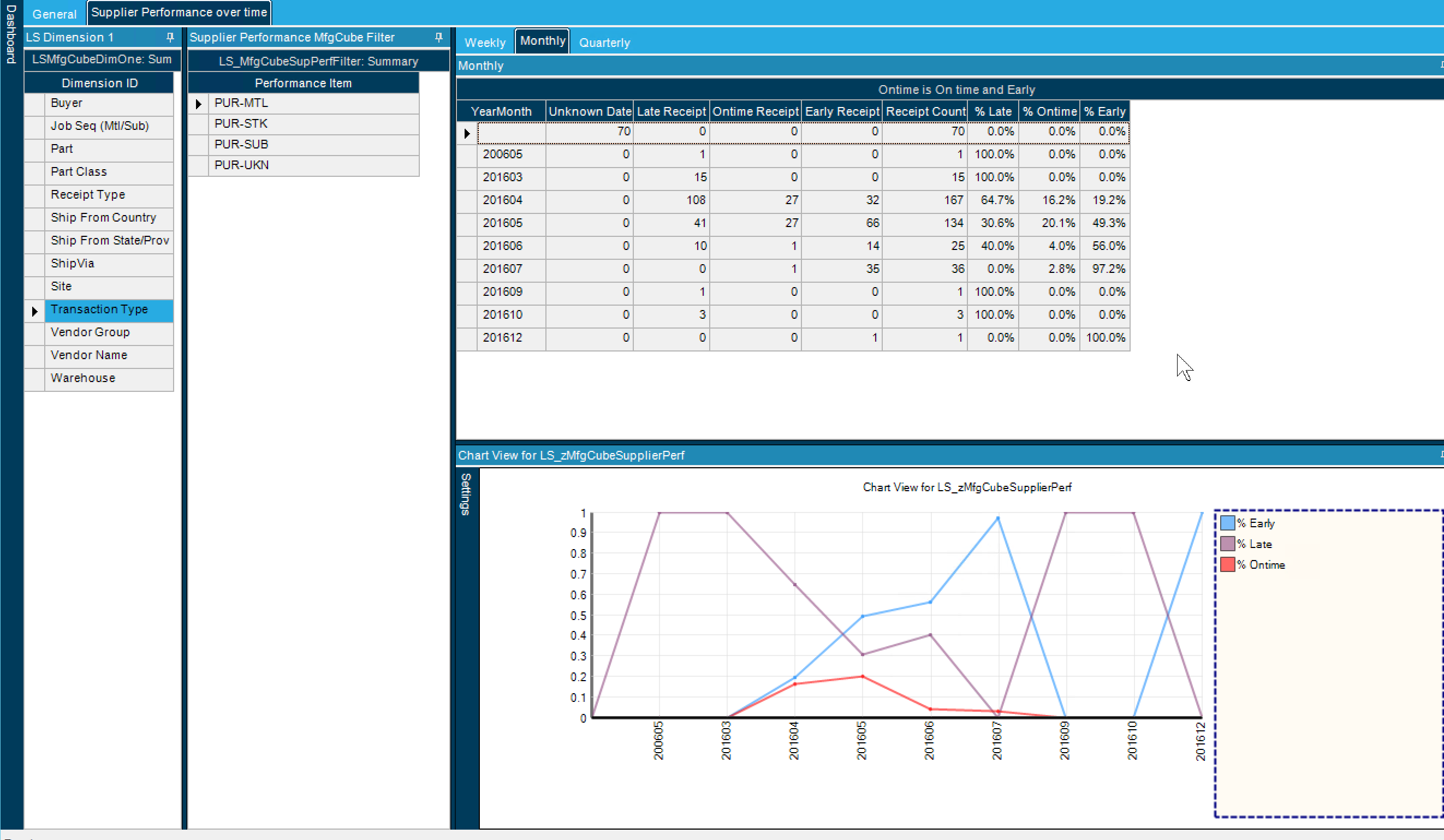

THere is a shop vision dashboard that will show you on-time delivery from suppliers (also shipments to customers) it is located under Executive Analysis -->ShopVision.
Most of the Shop vision reports are Executive queries that require a process to be run to store the data in a cube. To run the process go to Executive Analysis–>BAQ–>General operations–>Schedule processes and select the process to run.
You should consider setting to run at least on a weekly schedule.
I did find that I needed to modify the query for the dashboard to calculate a percent on-time versus just a quantity of receipts on-time.
If you want to modify the system Dashboard, make a copy of it.
Second to update the query to put in percentages, open that one an make a copy of it.
Return to the dashboard to replace the system dashboard with your fixed query.
Also, somewhere along the revisions, Epicor broke this dashboard by changing how the dimension dashboard was calculating. Check the publish and subscribe links
Here’s the finished product.

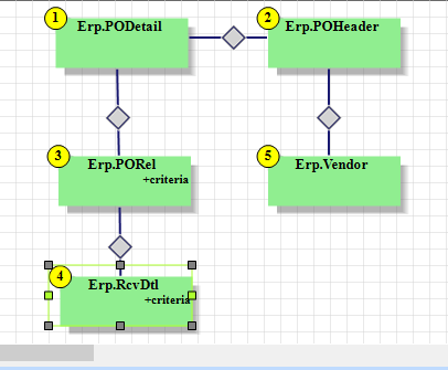

We have been using the below BAQ to track supplier performance for several years. I have also included a shot from the Query Builder for some clarity.
select
[PODetail].[PONUM] as [PODetail_PONUM],
[PODetail].[POLine] as [PODetail_POLine],
[PORel].[PORelNum] as [PORel_PORelNum],
[POHeader].[BuyerID] as [POHeader_BuyerID],
[POHeader].[OrderDate] as [POHeader_OrderDate],
[PODetail].[ClassID] as [PODetail_ClassID],
[PODetail].[PartNum] as [PODetail_PartNum],
[PODetail].[LineDesc] as [PODetail_LineDesc],
[Vendor].[Name] as [Vendor_Name],
[Vendor].[VendorID] as [Vendor_VendorID],
[Vendor].[VendorNum] as [Vendor_VendorNum],
[RcvDtl].[PackSlip] as [RcvDtl_PackSlip],
[PORel].[PromiseDt] as [PORel_PromiseDt],
[PORel].[DueDate] as [PORel_DueDate],
[RcvDtl].[ReceiptDate] as [RcvDtl_ReceiptDate],
((case when ((PORel.DueDate) is null) and ((PORel.PromiseDt) is null) then 1 else 0 end)) as [Calculated_UnknownRecpt],
((case when ((PORel.DueDate) is null) then 0 else (case when RcvDtl.ReceiptDate <= dateadd(day, -7, PORel.DueDate) then 1 else 0 end) end)) as [Calculated_EarlyDue],
((case when ((PORel.PromiseDt) is null) then 0 else (case when RcvDtl.ReceiptDate <= dateadd(day, -7, PORel.PromiseDt) then 1 else 0 end) end)) as [Calculated_EarlyProm],
(case when RcvDtl.ReceiptDate <= PORel.DueDate then 1 else 0 end) end)) as [Calculated_OnTimeDue],
(case when RcvDtl.ReceiptDate <= PORel.PromiseDt then 1 else 0 end) end)) as [Calculated_OnTimeProm],
((case when OnTimeProm + OnTimeDue > 0 then 1 else 0 end)) as [Calculated_OnTime],
[PORel].[XRelQty] as [PORel_XRelQty],
[RcvDtl].[OurQty] as [RcvDtl_OurQty],
((case when RcvDtl.OurQty < PORel.XRelQty Or RcvDtl.OurQty > (PORel.XRelQty*1.05) then 0 else 1 end)) as [Calculated_QtyDiscrp],
(1) as [Calculated_RecptCount],
(Erp.FiscalPeriod(@CurrentCompany, RcvDtl.ReceiptDate)) as [Calculated_RecptMon],
(Erp.FiscalYear(@CurrentCompany, RcvDtl.ReceiptDate)) as [Calculated_RecptYr],
(dateadd(day, -7, PORel.DueDate)) as [Calculated_EarlyDate]
from Erp.PODetail as PODetail
inner join Erp.POHeader as POHeader on
PODetail.Company = POHeader.Company
and PODetail.PONum = POHeader.PONUM
inner join Erp.Vendor as Vendor on
POHeader.Company = Vendor.Company
and POHeader.VendorNum = Vendor.VendorNum
inner join Erp.PORel as PORel on
PODetail.Company = PORel.Company
and PODetail.PONum = PORel.PONUM
and PODetail.POLine = PORel.POLine
and ( PORel.OpenRelease = 0 )
inner join Erp.RcvDtl as RcvDtl on
PORel.Company = RcvDtl.Company
and PORel.PONum = RcvDtl.PONum
and PORel.POLine = RcvDtl.POLine
and PORel.PORelNum = RcvDtl.PORelNum
and ( RcvDtl.ReceivedComplete = 1 and RcvDtl.ReceiptDate >= ‘1/5/2016’ )
order by PODetail.PONUM, PODetail.POLine, PORel.PORelNum
