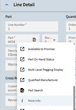

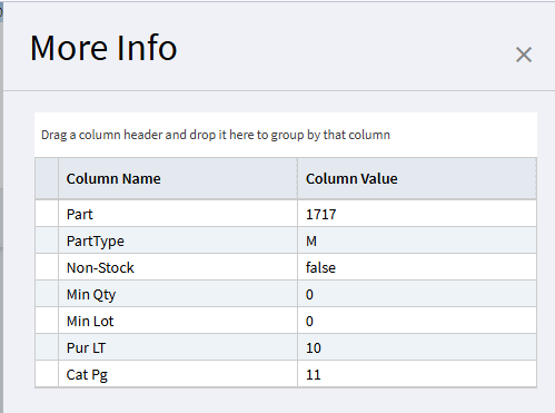

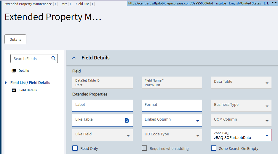

Zone BAQs are kind of a hidden gem for this kind of thing instead of a full on dashboard. Depending on how many columns you want that is. You make the BAQ include the binding field (partnum in this case) plus any other columns you want, share the save the BAQ as normal. In Extended Properties you set the zone BAQ to the BAQ:
In Kinetic you right-click and go to ā€œMore Infoā€ to open the zone BAQ and it opens a slide out. In Classic there is a little ā€˜tic’ mark they can hover-over.

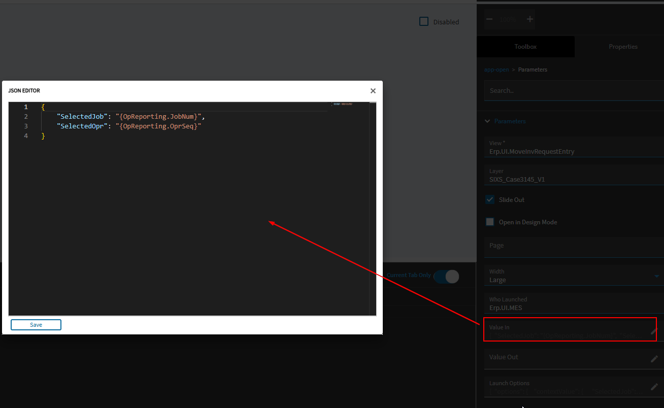

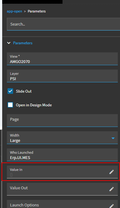

Here’s an example of passing with app-open using ValueIn property.
