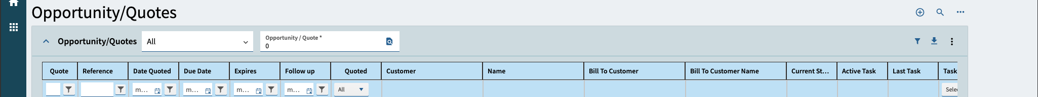

The landing page for Quote will not show filtering options for Customer, BillTo, etc fields. But for Order I am able to filter by Customer without downloading. None of these are UD fields which maybe I could understand but our end-users are super unhappy about this.

Yup, we are using the browser, not the desktop client. But, it still happens in the client as well.
We do have UD fields but I didn’t pull them or personalize them for me. Plus, I have it set up as the default columns from Epicor. We have not customized the landing page but we have for the actual quote and order screen
Unfortunately, that’s only a temporary workaround. I need to be able go back to my users and give them an actual fix.
I have the default from Epicor set to 500 and we are still below 500 Quotes. I even changed it to 1,000 and still, the filters aren’t searchable without downloading.

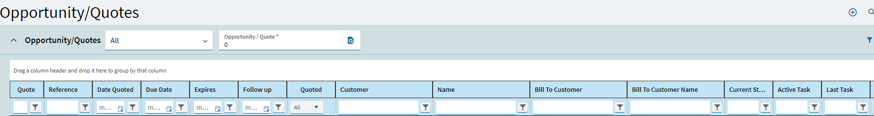

I may be misremembering, but I’m pretty sure how we fixed it in the short term was a bit of a hail Mary. Have you tried dragging any of the fields more to the left in the row? One of our user’s did this by mistake when they were showing us the issue and it actually caused the field to load correctly. So basically, we just had them moving the Customer, Name, Bill to Customer fields over to the left to get the text area to appear correctly. See the screenshot below for reference:
This may or may not still work, but worth a try if it’s an effective workaround for the time being. Eventually, our fields just started to work normally again after we upgraded.

Love the hail mary but just tried and didn’t work.
