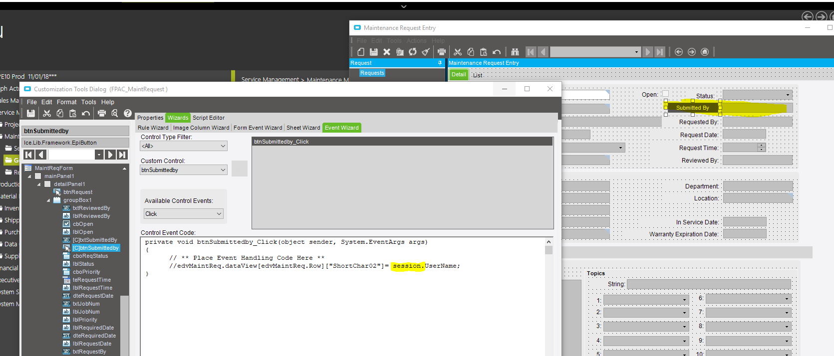

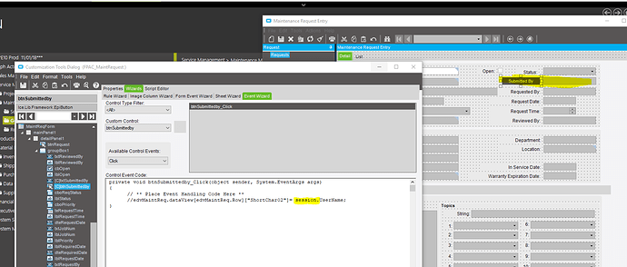

I have created a button on the the Maintenance Request Entry. When the user clicks this it should populate their name. Evidently I am calling the wrong thing and this is not my strong point. There error doesn’t like ‘session’.
any suggestions what his should be?
You need to add this to your usings if not there already
using Ice.Core;
Then to get the current user id it would be this
edvMaintReq.dataView[edvMaintReq.Row]["ShortChar02"] = ((Session)oTrans.Session).UserID;

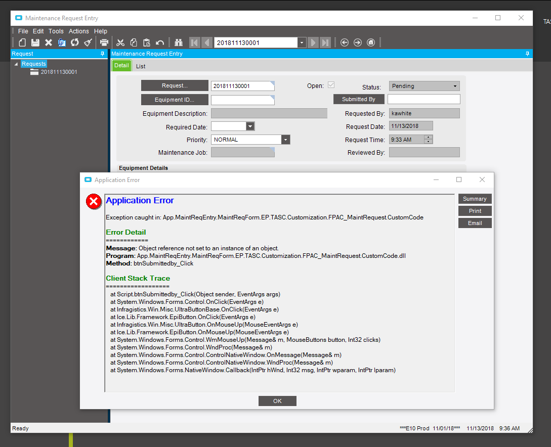

When I tested the code it said it complied successfully. But when I launch the customization I get and Object reference not set to and instance of an object. I can click ok past it but when I click on the submit button the error pops up…
Where is edvMaintReq getting instantiated? Can you include the entire customization code?

I would check the name of the EpiDataView as it might not be “MaintReq”. I don’t have the Maint module to check.
edvMaintReq = (EpiDataView)oTrans.EpiDataViews["MaintReq"];
edvMaintReq.dataView[edvMaintReq.Row]["ShortChar02"]=(Ice.Core.Session)oTrans.Session.EmployeeID.ToString();
//or for the user name:
edvMaintReq.dataView[edvMaintReq.Row]["ShortChar02"]=(Ice.Core.Session)oTrans.Session.UserName.ToString();
That is if using E10…which your tag in the title indicates…
But I went into my maintenance request module and here is how it was declared using the wizard:
private EpiDataView edvMaintReqView;
this.edvMaintReqView = ((EpiDataView)(this.oTrans.EpiDataViews["MaintReqView"]));
