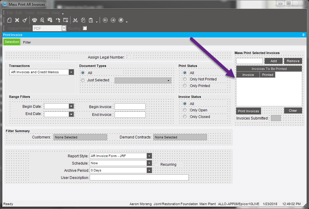

I have a customization I wrote on Mass Print AR Invoices that simply cycles through a list of invoices that the user enters and prints them to PDF. When the user enters an invoice number in the blank field next to the add button and clicks “add”, it adds a row to an empty data table that is created when the form is initialized.
If the customization is called from a invoice key field like in the AR invoice tracker, it will bring in the invoice number from the EpiDataView. It’s nothing earth shattering, but it might be helpful.

I have one user who always has a persistent record in the list of “to be printed” invoices. Interestingly, it is always the same invoice record that persists. There is nothing unique about this invoice, from what I can tell.
When I have any other user pull up this customization, it does not have this invoice record selected.
I have tried clearing the users cache, clearing the users personification, but nothing is working. Any tips are appreciated, thank you
